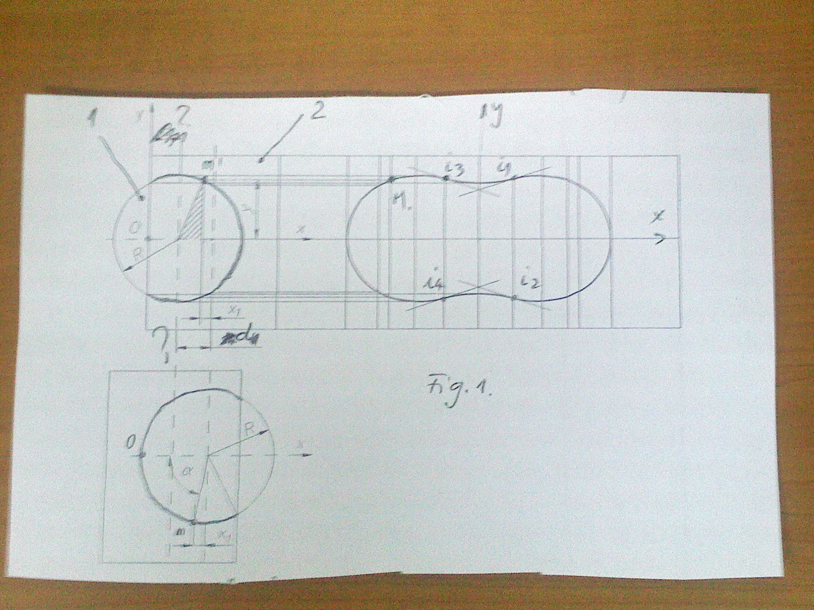

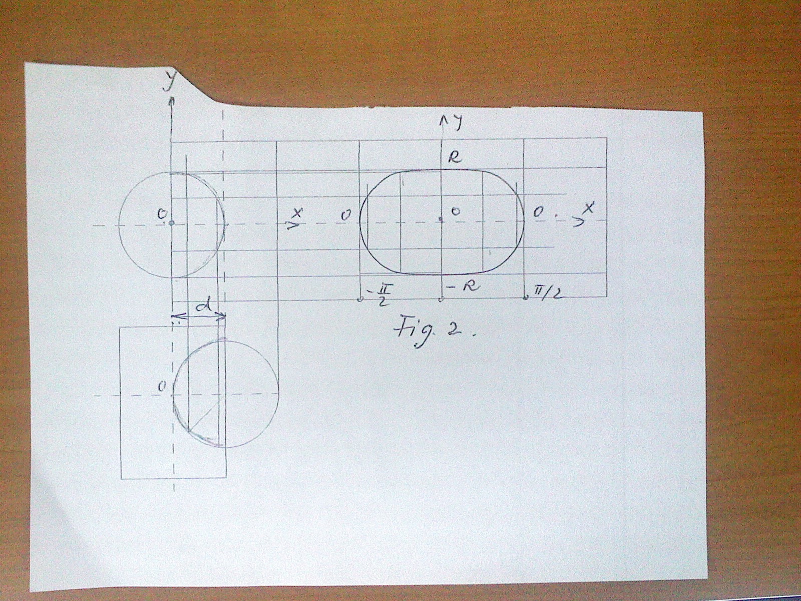

Hello, my name is Alex and i am a student at the Polytechnic University of Bucharest.
I have never used this software before and it is getting very dificult finding what i need.
My industrial design teacher has given me some equation stuff to work, but i never used mathcad.
I have to create in mathcad 2 cylinders that would intersect and after that make some calculations.
The first is vertical and the second should passthrough the first but horizontaly, i've attached a photo, hope this will be usefull.
He explained me that there ar 3 scenarios i need to test, all based on assigning a diferent value to "d".
Please help if can

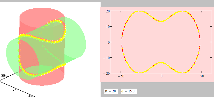

See attached. It should at least show you how to start.
Alan
April 12, 2013

Here is a Prime 2 version.
Alan
April 12, 2013
Thank you Alan, thats just wow what you did there, i wish i could find a starter tutorial on mathcad

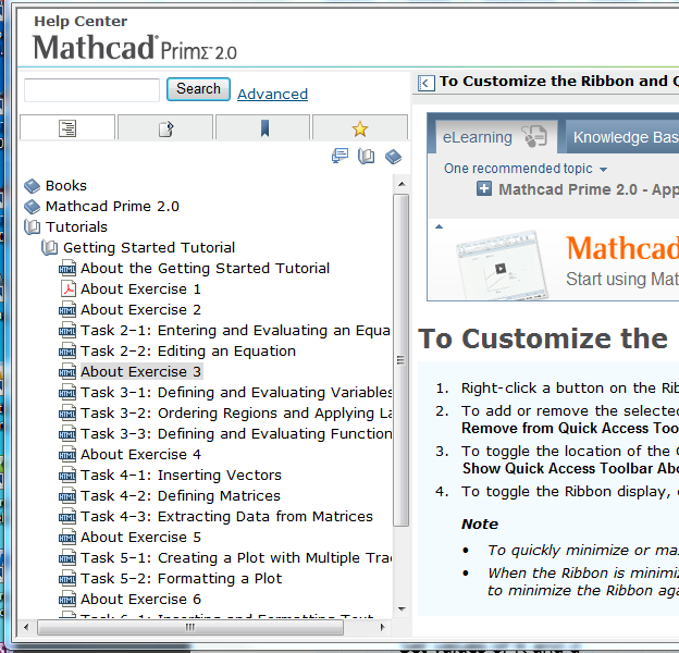

Alexandru Hera wrote:
... i wish i could find a starter tutorial on mathcad
Click on help (the question mark at the top-right of Prime 2). There is a tutorial there:
Alan

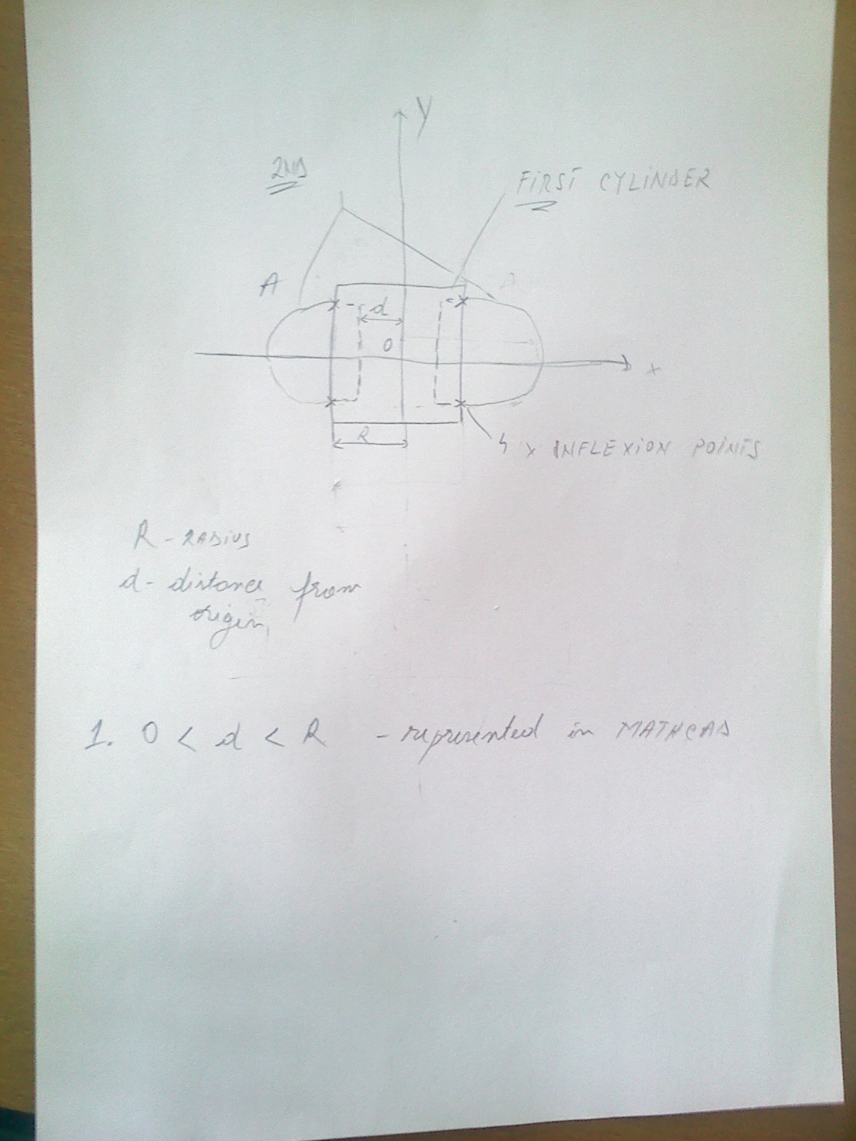

For better explaining Alan, hope you can understand exacly whan i need
the first scenario allows me to alocate multiple values to d and represent them.
April 12, 2013
Err...no!
1. What is the orientation of your 2nd cylinder? 2. What, exactly is it you are trying to calculate? Your first post suggested a number of discrete values of d. Are you now looking for a plot of y as a function of d?
I'm afraid I'll need a more detailed explanation/better drawings (make them 3D?).
Alan
April 12, 2013
Well, i am trying to calculate y based on the d value, 2d not 3d
The orientation is straight throught the first, like a nail.

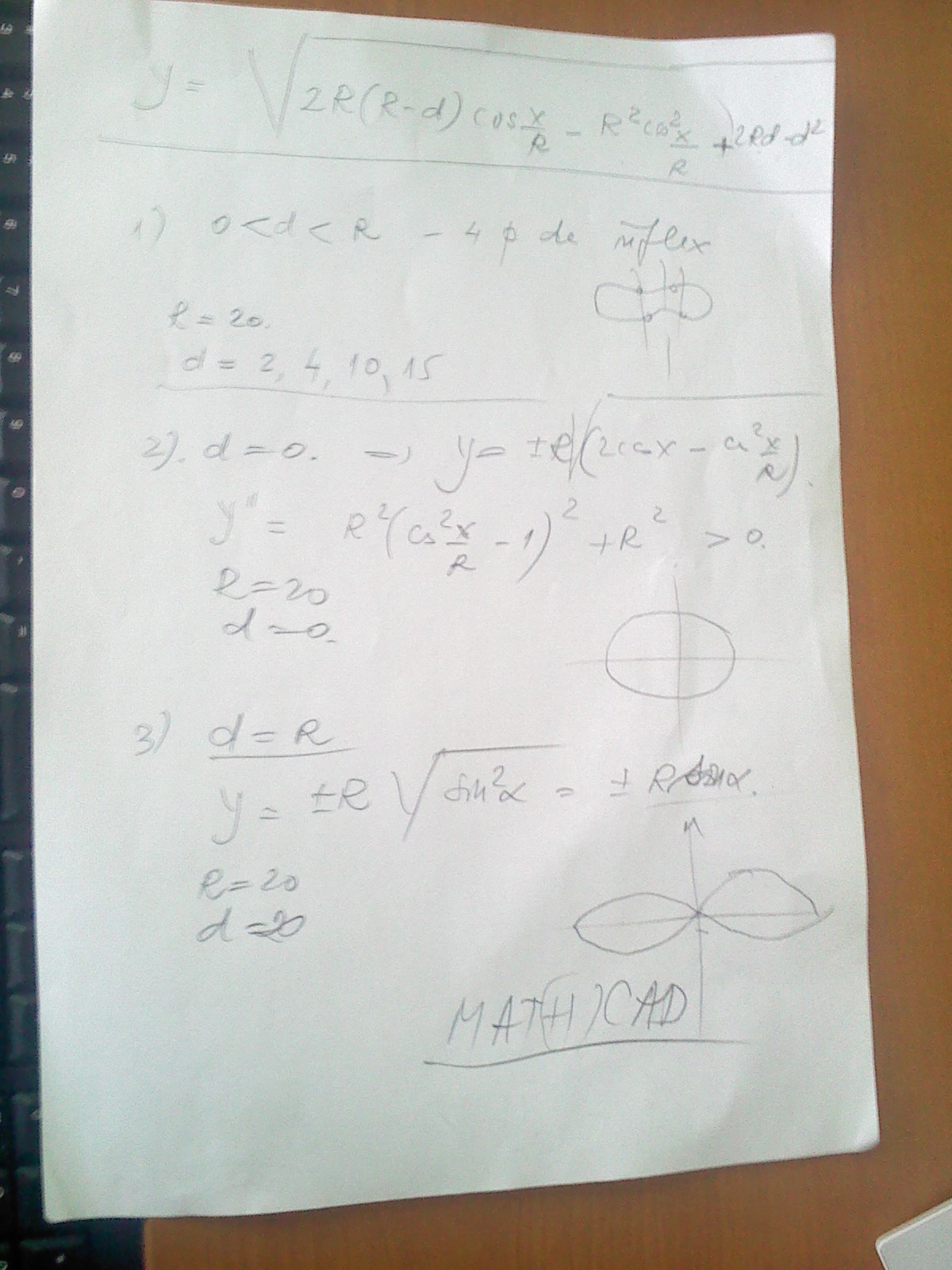

Okay, to get started, the title of the paper.
Graphic-analytical study of the curve of intersection of two cylinders of rotation
R - circles radius (same size)
d - distance between the cylinders axes
M (m,m') - intersection point
x = Rα (from the horizontal projection)
α = x/R
April 15, 2013
So at least a sketch worth the paper drawn on.
As far as I see its exactly the same thing we had before with one exception. The distance d is now more meaningful. In the equation of your first posting the variable d was the difference from R and the new variable d now, This would affect the equation, of course as d=0 now means we have two ellipses as intersection and therefore two sines as flat projection, and d=R would mean a curve without inflection points - exactly the opposite from the prior post.
The equation would be
and if the goal is graphing, then Alan had already provided the way to do.
Think its time for you to fire up Mathcad and create your own worksheet. Come back if there is anything not working.
BTW, in your sketch (is it yours?) you have different x-axis with different meaning - can be confusing.
April 15, 2013
Well, from the paper i have y^2= R^2 - (d-x1)^2, but thats so close.
I'll get to work.

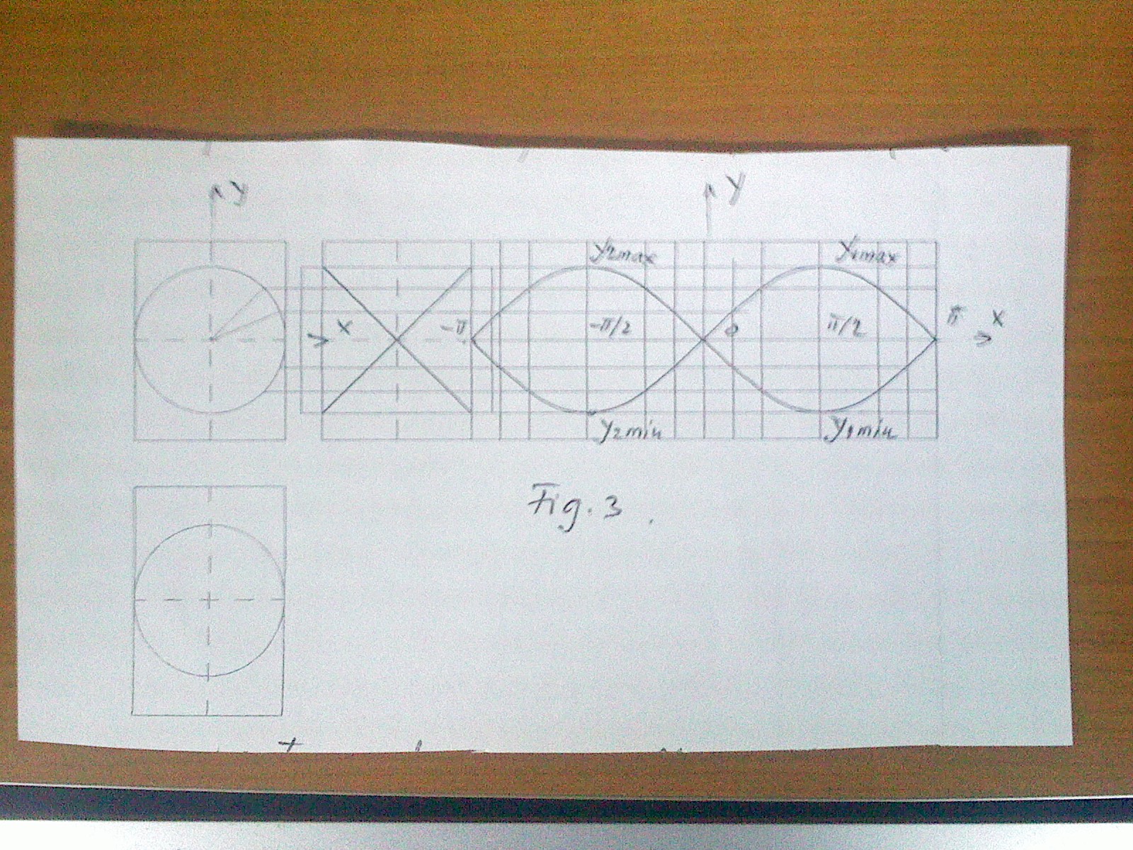

Yes, but how is it made with mathcad? cuz i want to modifiy the graph for any scenario in the theory, and for every y value.
Hmm, here are the other 2 scenarios.
#1 - Case when d = R
#2 - Case when d = 0
#3 - Case when 0 < d < R

I sent you all I have - unfortunately in MC15 format. If you can't model it in another software (preferably a 3D CAD for better results) you may consider using the free 30day eval version of Mathcad15.
Find attached a pdf from that file. At least plotting the two cylinders should work the same in Prime - plotting the intersection in 3D will need some different rework but probably is not necessary at all.
If you are just after a pic for every case you could use one of the animations I posted, pause the film, pull the slider to the position you want and take a screen shot.
