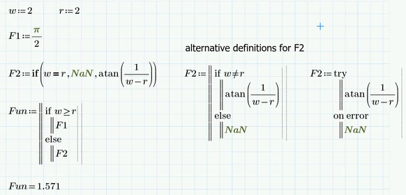

I second what Luc wrote about the worksheet. It should be possible in most cases to narrow down the problem and create and post a worksheet which shows what you are looking after and what fails.
In case of your problem this should be fairly simple! Its still unclear for example if w and r are defined on top of your sheet or if they are provided as function arguments. And you always talk about functions but you don't show any function. So its unclear if you are just sloppy when typing in here the part of the expression or if you misunderstood the meaning of a function in math and confuse it with "term" or "expression". When you write
F2=atan(1/(w-r))
thats not a function but rather the definition of a new variable F2 which Prime tries to evaluate no matter what the values of w an r are. Of course, when the variables w and r are defined above with the same value, this calculation obviously must fail.
If you really insist in splitting this simple and straightforward calculation into a series of single calculations, you may do it with functions like this:
Note that if w and r are defined above, fun must not necessarily be a function but may be a simple variable. F2 has to be a function which is only called when w and r are different.
And here are different approaches without any functions:
6 replies

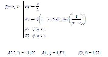

June 7, 2019
1. You don't need to submit your entire sheet. If you are allowed to publicise your construct in a clumsy textual way, you could also put that part in a (separate) worksheet and attach that, so: you should attach a (just a) sheet that describes your problem as concise as possible. (Yes, a picture may paint a thousand words, but a worksheet is superior to a picture!)
2. If properly formulated, the if statement WILL do the trick, as shown here
with w below, equal to and above r. No crash.
