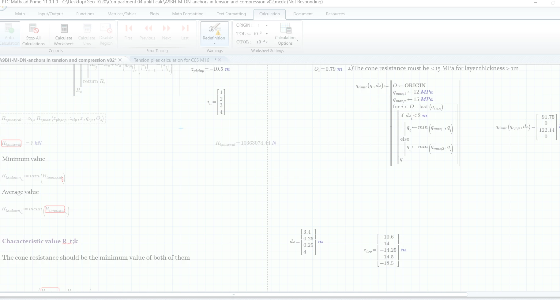

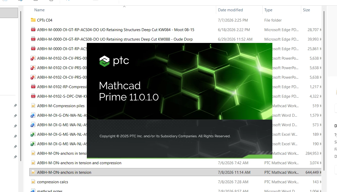

Today I can’t even open this file . It is heavy but does that mean It can’t be open

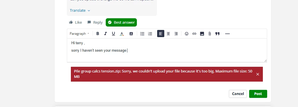

Can you upload the large file  so we can inspect it?
Jul 13, 2026 6:51 AM UTC
Hi terry ,
sorry I haven’t seen your message . It can’t be uploaded here although it is zip file . can I get your email please , so I can just send it to you

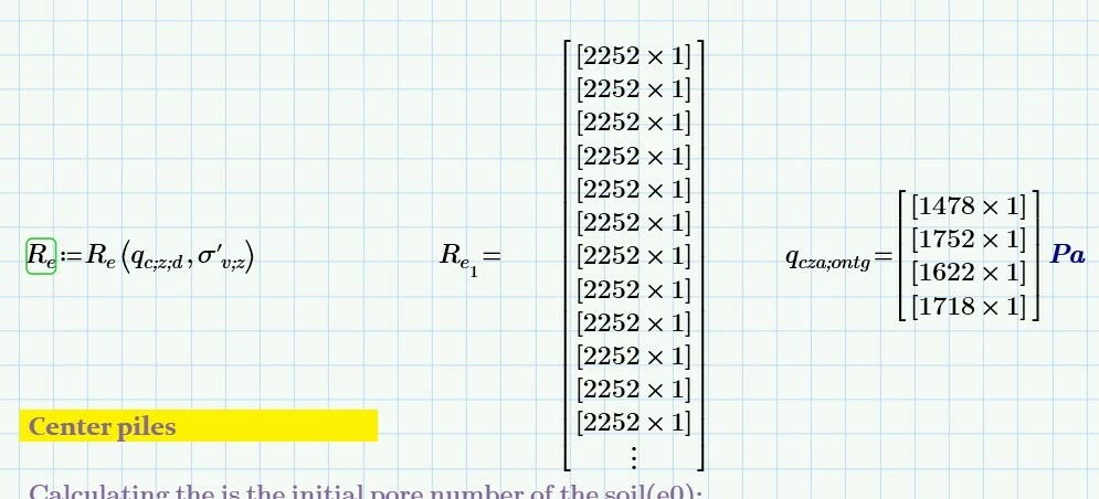

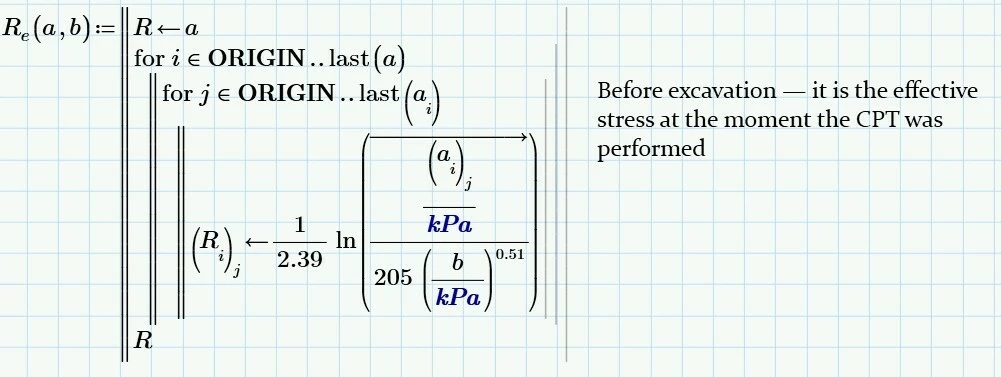

Have found the source of the large file size.  The data set that is being worked on should not be a problem for Prime.
There is a number of instances of a variable name and a function with the same name, not a good practice.  f2, M, Re.  It is the calculation of Re that is causing the large file size. In the files attached I have disabled the regions that calculate Re, f1, and f2.
Definition of Calculation of Re
Then Re is calculated but returns a result I am sure is not correct.
Vectors of 1478, 1752, 1622 and 1718 long with each element containing itself a vector of 2252 in length ​​​​​​
I am sure this is not intended.  Work on recalculating Re.
