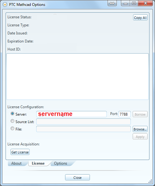

I have a problem with Flexlm: I want to add Mathcad license to Flexnet Publisher server with some other licenses aleredy installed.
Flex is litening on 27000-27009 ports;
vendor daemons are listening on various ports like 2068, 2080, 2084, etc.
I want to run PTC vendor daemon (ptc_d.exe) on 2070 port:
1. I edit  license  file:
originalmodyfied
SERVER __HOSTNAME__ PTC_HOSTID=00-12-34-56-78-9A 7788
DAEMON ptc_d __PTCD_PATH__
SERVER license-server.fqdn.name HOSTID=00-12-34-56-78-9A
DAEMON ptc_d PORT=2070
2. I import license file to FlexNet Publisher - success - daemon start
But client cannot connect to server - we try to enter ports: 27000 or 2070, but it does'nt work.
What should I do?
Greetings

December 14, 2016
if I understand you well then you own Mathcad floating license. I hope you installed PTC FLEXnet on license server and when you launch ptcstatus.bat file, you can see that Mathcad license is available.
Please read attached MED-60895-EN-230_F000.pdf. If you use information included in this document, you will be able to launch following window and enter the appropriate license path information. servername = license server name (usually I launch ipconfig  /all command to see the name).
Suggestion: If Firewall is running on license server, turn it OFF temporarily. This way you will prevent blocking of Mathcad license by Firewall. Later it is possible to turn Firewall ON again and configure it properly to enable access to Mathcad license.
