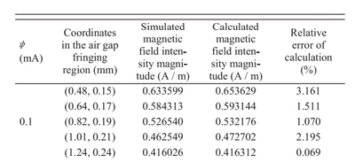

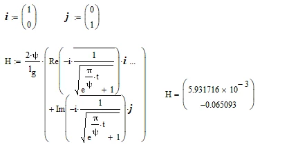

Hi experts,

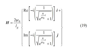

Can Mathcad solve the below equation?
because I would like to get the result like the below table, but I don't have any idea how to solve equation 19.
for example, when the coordinates are (0.48, 0.15), the result should be 0.653629. but I think my equation has an issue in there, so the result is wrong.
Could you please give me some ideas?

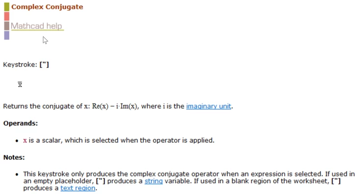

Can you tell me how you type the bar on it?
The complex conjugate operator can be applied by typing the double quotes " as Luc already wrote.
You may also look it up in the Mathcad help

Obviously you DON'T want to SOLVE an equation but rather want to numerically evaluate an expression.
I notice the conjugate operator in your Eq.9 and I guess the i and j are unit vectors in orthogonal directions so H may be a vector whose absolute value is 0.65...
Would any of the following help?
Your screenshots don't show how the coordinates should affect the value you are looking for.

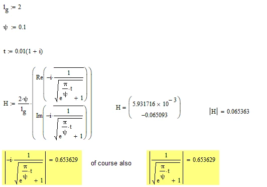

BTW, if you set t := 0.01 + 0.01 i, the last expression returns 0.653629, exactly the value which is listed in your table as calculated value ...

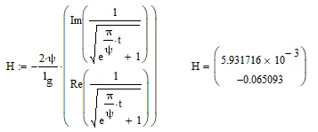

May I know how you type the vector?
I also try to set t = 0.01+0.01i but the result is not 0.653629.
Can you tell me how you do that?

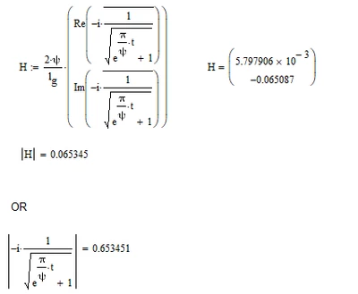

Here you are ..
file attached
A vector/matrix is created by typing Ctrl-M
I don't know if my suggesting concerning H being a vector does make sense. But if, then you could also create it in a way more similar to what we see in your pic of equation (19)
A more straightforward way would be
