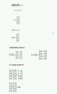

Hi guys
I have issue with matrix multiplications.
Please see the file and (hope) help me with it.
Best regards
Andrzej

Hi Andrzej,
I'm not near a Mathcad PC at the moment, but it looks like you have fallen into the long-standing Mathcad "it looks like a vector but it isn't" visual trap.
The key thing to note is that a range variable (s in your case) is *not* a vector (which I'm sure you already know).   However, the result of evaluating a range vector can look very much like a vector.
What you need to do in the above instance is convert s to a vector.   This you can do by the simple expedient of typing "=" after defining s.  Mathcad will then convert the range (1,2..4) to a vector and assign it to s.  I don't like this trick, for a variety of reasons, but it is fairly common practice.   Hopefully, you should the see the result you want.
As for why you don't see the intended result, the next key thing to note is that Mathcad treats a range variable (s) as an implicit loop operator.   Mathcad evaluates s for each value of its range.   If you simply evaluate s, then Mathcad displays the evaluation as if it were a vector, but, as stated earlier, it's not - it's  a list of the results of each individual evaluation stacked up on each other to look like a vector.
In your first vectorized expression, Mathcad will calculate b*a(1) and display the result at the top, then b*a(2), and so on.  Mathcad further confuses the range vs vector display by collapsing each of the individual results to make the output look like a nested vector.
Your final example works because each of the two data items actually are vectors.
Hope that isn't too confusing.

Jul 29, 2022 9:33 AM UTC
Hi Stuart
Its so simple solution that I will never come up with it 😉
Thanks a lot
Andrzej

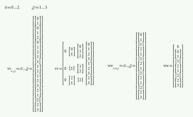

Here are a couple of examples where the "displayed" value differs from the actually calculated value.
That's why I usually prefer to explicitly define vectors and not use 'tricks' that don't generalise.
