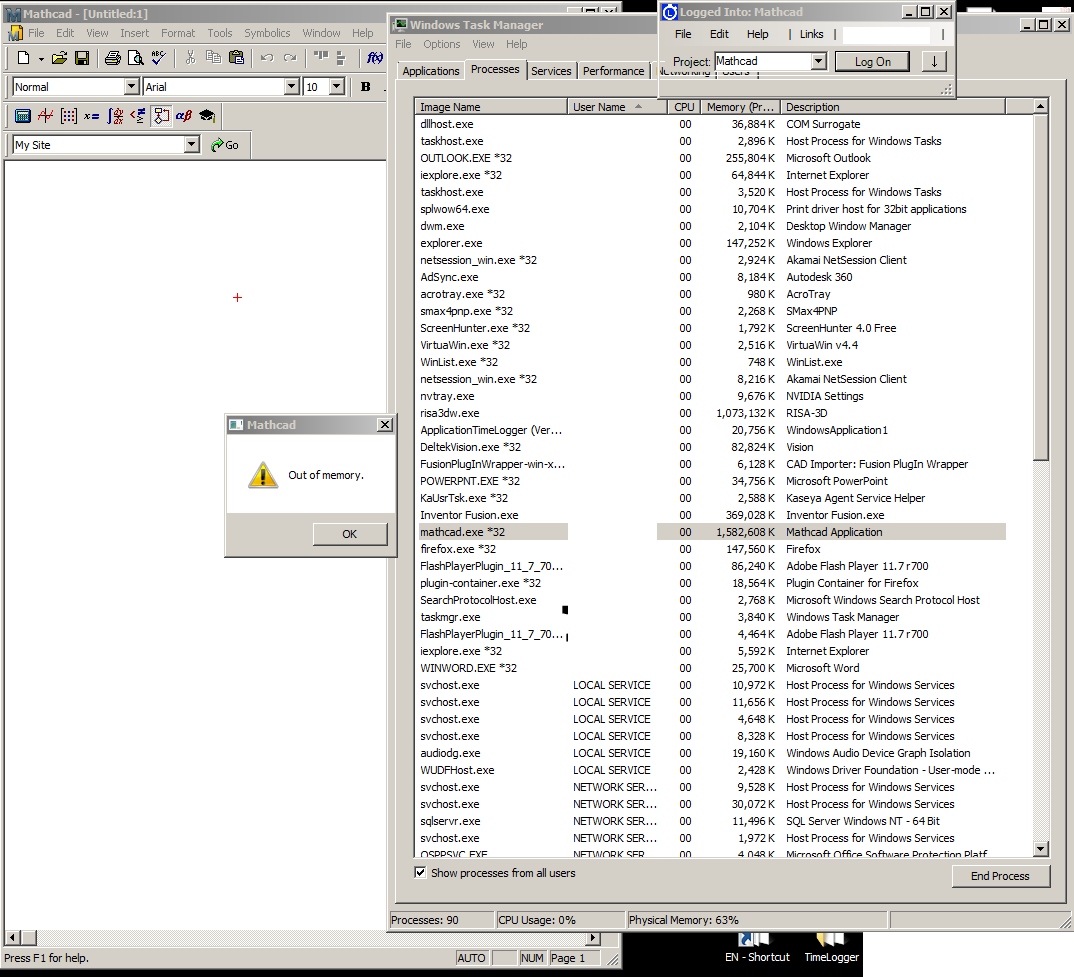

OVERVIEW:
1) I copy a large table from RISA-3D
2) Open a blank Mathcad Sheet
3) Look in Windows Task Manager, The Memory for mathcad.exe *32 increases DRAMATICALLY when Mathcad has focus, when Mathcad doesn't have focus; Memory only increases by 500 KB per second.
4) this 'RAPID' Memory use can be terminated by copying something MUCH smaller (i.e. A string variable from mathcad itself)
5) After copying something smaller, mathcad sill has a large memory allocation; only way to free it is to terminate the Applicaton
6) If I fail to copy something else; mathcad runs out of memory preventing me from saving and eventually crashes.
SPEC:
Mathcad 15.0 (15.0.0.436 [006041742]) -> MC15 M020
Windows 7 Proffesional; Service Pack 1 (64-bit)
QUESTION:
Is there a fix? OR am I just going to have to copy and past quickly?

That is Correct. Copied, Opened up Mathcad, and within 80 seconds:
Identical results when mathcad is opened during the copy operation.
Catch 22 is that I'm pasting the information into Mathcad, so I merely cannot avoid making large copies w/ mathcad open. However, I do have an 80 second window to paste and save. I am able to reopen the file and work with it without losing memory, its just when I have something in the clipboard. This is actually kind of scary considering I'm not telling mathcad to do anything WITH the copied information and its crashing.

Initially, I was saving the data in ".xls" format, but Excel wasn't capable of the large copy and paste I was doing; that is to say that I had more than 65536 rows... a lot more to be exact. I could use a ".txt" and input the table that way into mathcad, but my problem isn't that Mathcad cannot handle the memory of the large amount of data (on the contrary, Mathcad handles the data VERY well) but that it cannot control itself when there is a large amount of data on the Clipboard. I think this is an OLE interface issue... because when Mathcad is busy (lets say an infinite loop I put it into constantly check memory usage) the memory does not rise, but as soon as I terminate this process; mathcad resumes its memory feeding frenzy.
