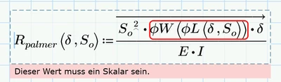

Hi All,
Working with multiple input data as matirx or vector and  got a error message on function cannot be use here.

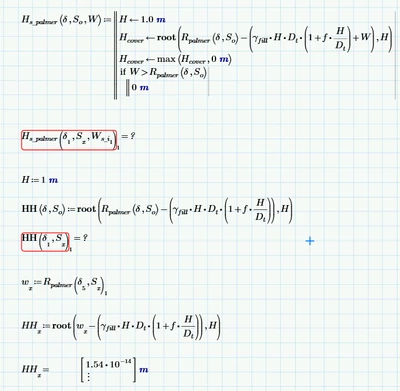

Root function solve if I rewrite the R into a wx,
Appreciate some advise to see what can be done to solve this multiple combination function by recalling the variable I like to combine in the equation.

Actually your sheet is to confusing for me so I can just note what I noticed.
At first you have to realize that writing B]x does not create a matrix even though it may (unfortunately) look that way in Prime.
The vector in your sheet is simply S

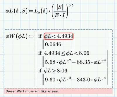

still throws an error and if you use Prime's error tracing you arrive at
The next position is

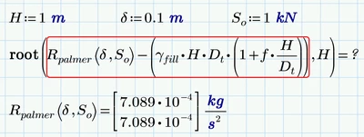

So I suggest you follow the error chain and manually evaluate the functions using the very same argument(s) you use in the offending function call. That way you may see which functions returns a data structure which is not compatible with the function you defined.
The reason for the root function failing may be the R.palmer function, because this function does not return a scalar but a 2x1 vector
Not sure if the R.palmer function is supposed to return that vector.
Using just the first element of this 2x1 vector makes at least the root function work
