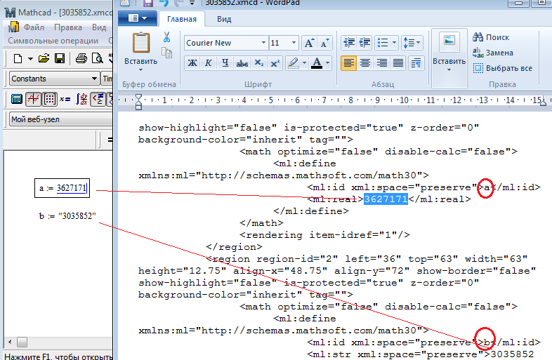

  1. Can I somehow change data within a MathCad file and have it update dependent quantities without opening MathCad? Say I write a script to find and replace a value within the xmcd file. I'd like to be able to have all variables update at that point and then extract updated information from the xmcd file with the script, without ever having opened MathCad. Or is the only way to update values to physically launch MathCad? I suppose some type of command-line/batch update "mathcad -b ..." would do the trick if it exists, but I am open to any ideas.

1. I hope you know it:
The only thing that can calculate a Mathcad worksheet is Mathcad, so you have to run Mathcad in some way. One way to do that is to call it from another program via the automation interface. Then you can load a worksheet, change variables, recalculate the worksheet, and get the results. All of this can be done with Mathcad running in the background, so you don't see it, but it's still running. See the developers reference (under the help menu) for more details.
