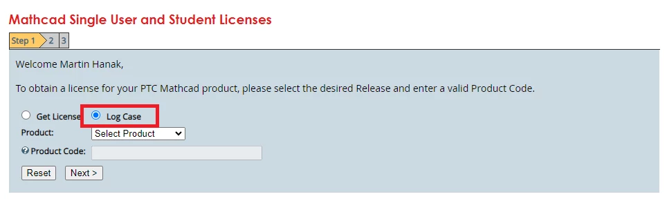

Jun 7, 2023 6:10 AM UTC
did you try Log Case option ?
You can also try sending email describing your request to academicsupport@ptc.com
This procedure is mentioned in https://community.ptc.com/t5/PTC-Education-Forum/Creo-installation-stuck-at-processing/m-p/828065#M13079 discussion.

Jun 9, 2023 2:05 PM UTC
PTC has replied that they have “retired” all versions of Mathcad other than the current version, and will not send me a license file.
