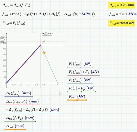

September 19, 2020
You typed manually 0.252 in the placeholder for that outermost vertical marker.
That would not change automatically. I guess it should have been "Delta.tot(f,F.p) / mm". You can type this in the placeholder (making it unitless by dividing by the desired unit is mandatory) and the plot later still will show the number. The same goes for the other markers.
Are you looking for something like this:
Prime 6 sheet attached

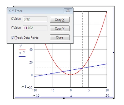

September 18, 2020
You mean like this?

September 18, 2020
The tracing option which you can see in Lucs picture is not available in Prime.
Also that tracing is not automatic in real Mathcad, too - you would have to move the cursor yourself to the position you want.
