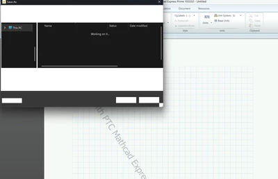

Mathcad prime 10.0.0.0 failing to save
Just as i thought the problem was solved it went back. I tried resetting my pc and downloading everything from scratch. I have a lenovo with windows 11 home. Everytime i try saving a document a corrupt saving page pops up. i will attach it here. Skærmbillede 2026-02-03 122031.png
It happens when i use; save as, save or any type of export.
I have tried reinstalling several times, also as administrator, and it has the same outcome.
When running the program as admin it gives 3 more seconds on the save window but inevitably it crashes again. I made sure i unpacked the download zip-file locally and not using onedrive. Also i placed the app locally.

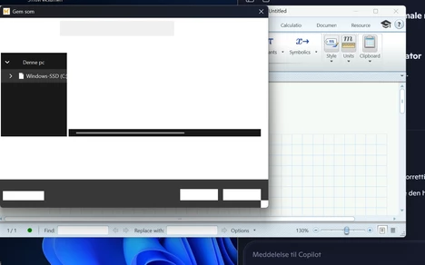

I tried changing the windows language to english. i still have the same thing happening unfortunately. I got a new pc today which needed to be set up. i did not download the latest software updates for windows in the settings before downloading mathcad. This actually made it possible to use mathcad and save files. but when i later downloadded and installed the latest updates from windows it crashed again when trying to save. I might suspect some compatibility issue with a windows update and the program. could this be the case?

That certainly could be the case. It wouldn't be the first application (not even the first Prime) that suffers from a windows update or hotfix. The strange thing though is that only you seem to be affected by it. That could be when your PC has certain hardware that requires a specific update.
I've checked that my Prime 10 (express) on Windows 11 runs and saves fine.  I've updated my Windows 11 to the latest update, the 2026-01 Preview Update (KB5074105( (26200.7705) just now, and the result afterwards is the same: runs and saves fine.
