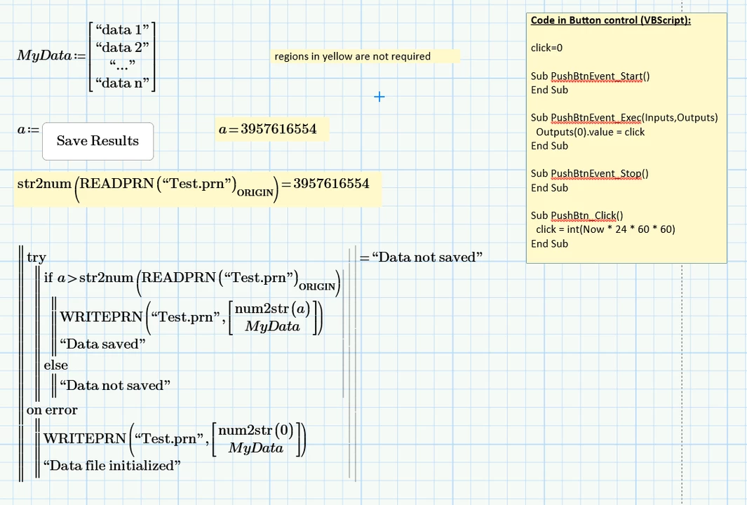

Hi!
Is there a way to implement MathCad Prime Advanced Controls to execute WRITEPRN function on button press using Version 10 Advanced Controls? This is so that WRITE or APPEND will only be performed upon the user clicking on the button.

Try this workaround:
  1. First setup your output file by writing a "1" in the same file (using nested matrices) or in a separate file.
  2. Now in your calculation document, before your control button, read the value of the number and feed that as an input into your control button.
  3. In your control button, when the button is pressed, output the number+1, otherwise output a zero.
  4. At the point you want to save your data, compare this number with the number in the file.  If the new number is higher, then save the data, along with the new number.
"It's OK to fall in love with your heart, but you design with your head." Omer W. Blodgett
SPaulis
May 29, 2025 12:02 AM UTC
@ttokoro made a good point .  Here is my version using the date+time, down the the second.   This is in VBScript but I am sure there is an equivalent in Java.

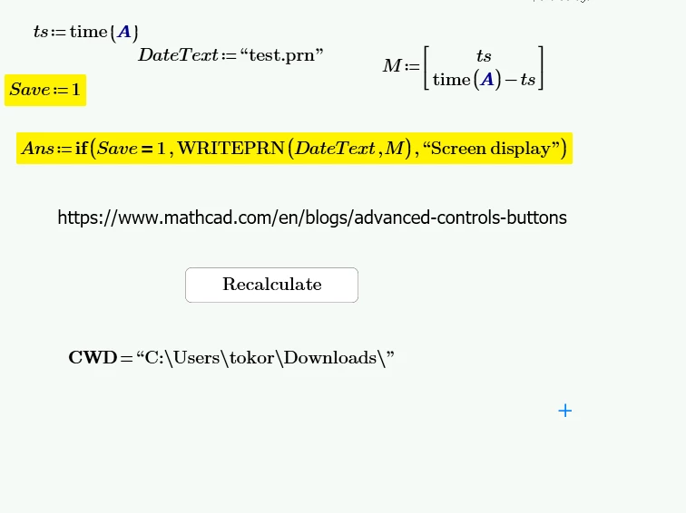

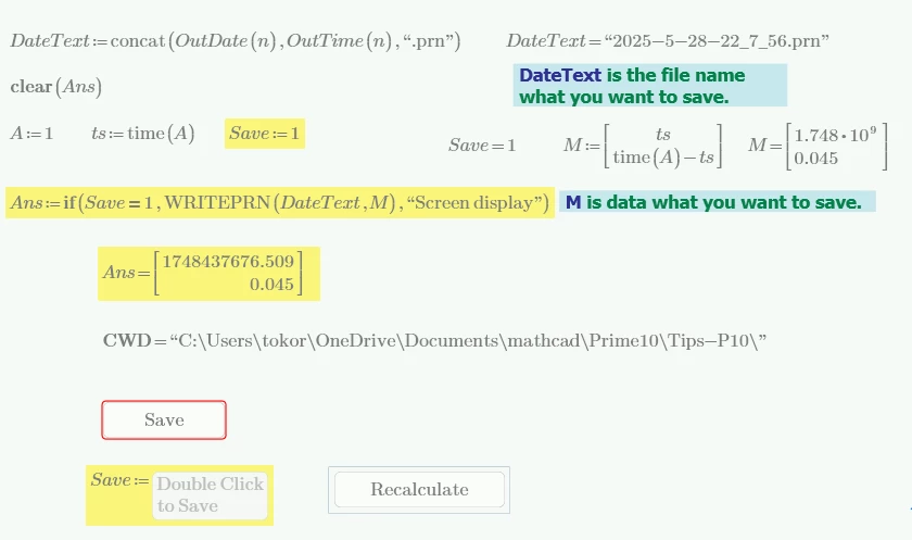

ttokoro
May 28, 2025 10:57 PM UTC
Prime 11 fall in infinity roop.
Prime 10 save just one time when push the button.
