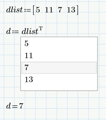

I have an array (numbers of rows - 1,  number of columns - can be different). Example: I enter a variable in mathcad d = [1 5 10 15] and i want this array to be displayed in my list as d = 1   d= 5 etc... Help please. Preferably in JS. Translated using Google Translate.
Best answer by Werner_E
Which list? And where? An external text file?
Please specify more precisely and if possible give one or two examples to show what you are looking for.
Ahh, you shouldn't hide important informations just in the thread subject!
In case you are looking for a vector to be the input for the items of a list box, you will find some examples here in the forum - some more , some less sophisticated.
A simple one is attached - hope it helps

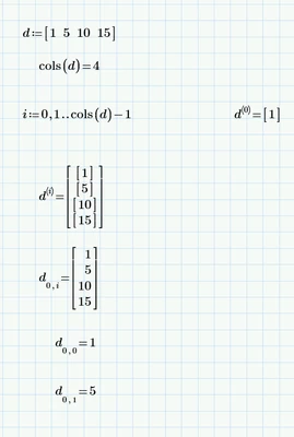

18-Opal
March 14, 2025
Like this?
Werner_E25-Diamond IAnswer
March 14, 2025
// TODO: Add your initialization code here
// Initialize Selection If desired
ListBox.CurSel(0);
function ListBoxEvent_Start(Inputs, Outputs) {
 // TODO: Add your code here
function ListBoxEvent_Exec(Inputs, Outputs) {
	var options = Inputs[0].Value;
	ListBox.ResetContent()
	for(var i=0; i < options.length; i++) {
	ListBox.AddString(options[i]);
	Outputs[0].Value = options[ListBox.CurSel()];
function ListBox_SelChanged(Inputs, Outputs) {
function ListBox_DblClick(Inputs, Outputs) {
6-Contributor
March 14, 2025
This is exactly what i wanted, thank you
