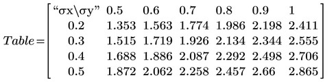

I need help evaluating a function of a range of variables using a solver block.
On page 1 and page 2 of the attached mathcad sheet, I evaluate a function F(z).
This (cumulative distribution) function is called Fz and is a convolution integral of 2 Rayleigh distributions. The variables X and Y are responses, where its RMS value within each Rayleigh distribution is known for and input to the sheet. Then, random variable z , is solved with a solver block. This all works.
On page 3 I want to repeat this process for a range of RMS values of X and Y. If X is an array of values with length 3 (on the rows) and  Y is an array of values with length 4 (on the columns), the total number of output values is 12 in the matrix.
I am working in mathcad prime 10.
Werner_EAnswer
Jul 15, 2024 3:40 PM UTC
You have to turn all calculations (including the solve block) in functions depending on sigma_x,sigma_y (and maybe also the desired probability level) from th every start.
The attached file should help.
Werner_E25-Diamond IAnswer
