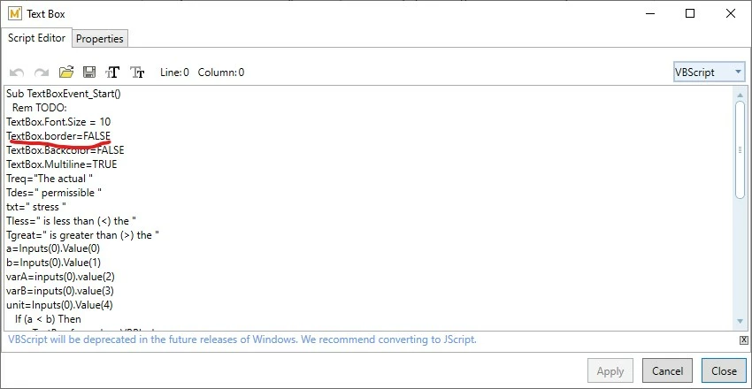

Hi folks,
has anybody figured out whether the textbox can change/adjust:
  • fonts
  • switch on/off the border (see image)
  • removing the output variable entirely
It seems to me that Prime 10 is lacking these features in text boxes.

Removing the output would make sense if the text box is just used to display a result like the "pass" and "fail" in the thread Luc had linked to.
In this case its useless to have to assign the textbox to a variable which we do not intend to use.
Of course we can assign the box to a dummy variable and then hide and collapse the left hand side of that (unnecessary) assignment.
But I too sure would be interested how to change the font family, font style, alignment, etc from within the script and being able to remove the border or change its look (double lines, shadow, ..) like we could do in Mathcad would be beneficial, too.
