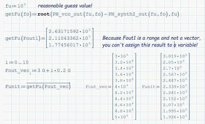

I would suggest to forget about the weak symbolics and rather use Primes numeric capabilities to get numeric results.
You may setup a function based on the "root" function which gets the desired solution for any input of Fout.
You may then call this function with your range Fout1 as argument or vectorized with a vector as its argument.
BTW, I don't think that using the "Re" function is necessary so I omitted it.

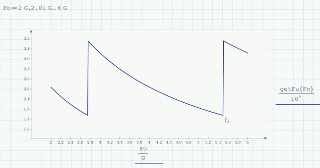

Of course you could also use the function to plot the results over a certain range of Fout values
Prime 10 sheet attached

Thanks so much for the speedy and awesome solution @Werner_E . I was about to abort MP10, and revert to M15 :).
