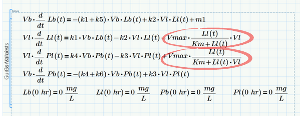

I am new to mathcad and am getting the error "unable to form derivative matrix" when using OdeSolve. I think i may not be able to use OdeSolve inline like I am doing. Can anyone confirm this. And what should I do instead? I am attaching screenshots below. I appreciate your help

You fixed the typo, but not the problem with the unit mismatch.
BOTH circled summands had different dimensions/units than the rest. So you can't add them.

Looks to me like a unit mismatch
Both highlighted expression (one of them seems to be a typo, I guess) have different units than the rest of the summands.
You should check your equations!

Thank you for noticing this. I went ahead and fixed it and am still getting the same issue.
I am unsure of how to attach the whole file, only how to attach an image or video.
Here are the new images. I tried doing it outside of the solve block as well.
