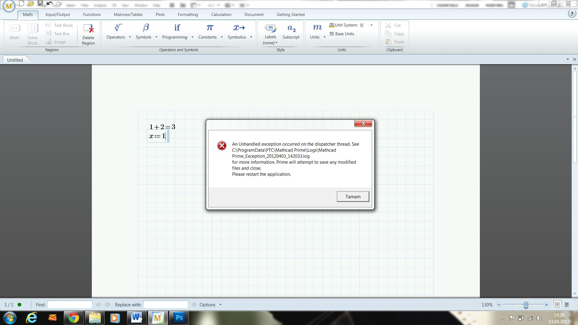

Hello Everyone when i try to write someting on mathcad prime i always recieve a message like this: "An Unhandled exception occurred on the dispatcher thread. See C:\ProgramData\PTC\Mathcad Prime\Logs\Mathcad Prime_Exception_20120331_182523.log for more information. Prime will attempt to save any modified files and close. Please restart the application." Please help me thanks...

What Windows OS are you using? Try to report about your issue here: "Mathcad Installation & Licensing Support Center".
April 2, 2012
I'm using Original Windows 7 Home Premium x64
April 2, 2012
Do you have installed Mathcad Prime 2.0 64-bit?

jhgjh kjhkjh wrote:
..."An Unhandled exception occurred on the dispatcher thread. See C:\ProgramData\PTC\Mathcad Prime\Logs\Mathcad Prime_Exception_20120331_182523.log for more information...
Did you send this log to PTC's technical support?
April 3, 2012
No i didn't send any log file how can i send it?
And i installed Microsoft .NET Framework 4.0 but you said enabled? How can i enable it?
April 3, 2012
"Mathcad Installation & Licensing Support Center": http://www.ptc.com/support/mathcad_supportCenter.htm
jhgjh kjhkjh wrote:
...And i installed Microsoft .NET Framework 4.0 but you said enabled? How can i enable it?
Through Control Panel --> Programs --> Turn Windows features on or off.

So there is an issue that requires you to change the language settings?
One of my users is getting this issue " whenever i try to modify texts or copy things from other programs to mathcad prime".
Any ideas? ThanksInline image 1
March 8, 2013
If take this mesage, you must change "Regional and language options" in Windows. It will be English(ABD).
March 8, 2013
In the Windows regions and settings it is set to English (United States). Which options need to be changed, there is no setting for English (ABD). This is a US English install.
