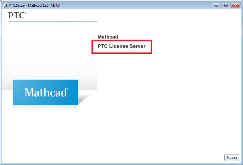

1. Send your issue to PTC's tech support by using "Mathcad Support Center":
http://www.ptc.com/support/mathcad_supportCenter.htm
http://blogs.ptc.com/2011/09/22/how-to-use-the-brand-new-online-mathcad-support-center/
2. Try to install license server from the latest Mathcad 15 M045 service release package, here: Thank You for Your Interest in PTC Mathcad 15 | PTC
