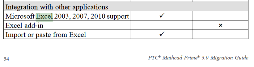

http://support.ptc.com/WCMS/files/157658/en/Mathcad_Prime_Migration_Guide_en-US.pdf contains following information:
My guess ... Mathcad worksheet "cannot find" Excel file.
MH
