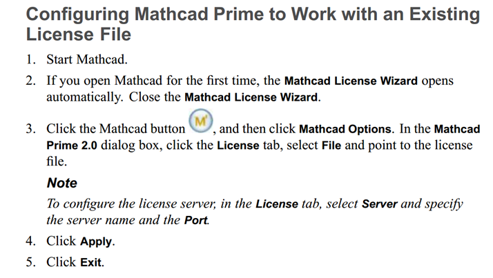

in the past when I had Mathcad Prime 2.0 installed, there was a file C:\Program Files\PTC\Mathcad\Mathcad Prime 2.0\Doc\en-US\Mathcad_Prime_Installation_Guide_en-US.pdf. I hope you can find similar file in your installation.
In my file following information was included:

OK, you have floating license.
If you open license file look at PTC_HOSTID in SERVER line. The value assigned to PTC_HOSTID is physical address of network card. Does it belong to your computer ?
If YES, then FLEXnet is installed on your PC. Do you know FLEXnet installation directory ?
If YES then you will find license.dat file in licensing subdirectory.
Now you can update the contents of license.dat file using your new license file. I use following procedure:
  1. open license.dat file in Notepad
  2. open new license file in Notepad
  3. select SERVER and DAEMON line in license.dat file, press CTRL+C
  4. select SERVER and DAEMON line in new license file, press CTR+V
  5. in new license file, press CTR+A, CTRL+C
  6. in license.dat file press CTRL+A, Delete, CTRL+V
  7. save license.dat file
  8. close and don't save new license file
  9. restart PC
  10. start Mathcad Prime and apply procedure mentioned in Mathcad_Prime_Installation_Guide_en-US.pdf
  11. Specify Server (name of your PC) and Port (7788)
