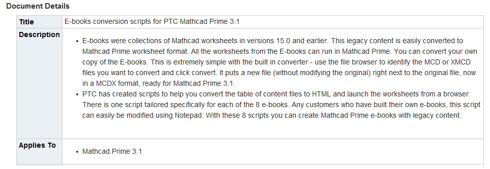

It is possible the following: you buy a Roark worksheets for Mathcad 15 and then convert them to Mathcad Prime version by using the built-in Prime converter. And the following script "Scripts to convert e-book functionality to an HTML table of contents" can be useful in this case: https://support.ptc.com/appserver/cs/view/solution.jsp?n=CS200084

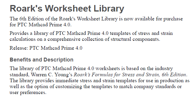

March 7, 2017
According with "Mathcad Prime 4.0 What's New" guide, quote: "the 6-th Edition of the Roark's Worksheet Library is now available for purchase for Mathcad Prime 4.0. Provides a library of templates of stress and strain calculations on a comprehensive collection of structural components".

March 15, 2017
PTC has posted a conversion routine for eBooks to Prime, see above.  The results is a set of hyperlinks to each of the tables.  Not as efficient as eBooks.  I use books to document my calculations.  The documentation includes the use of sub-folders.  The PTC conversion routine will not convert these eBooks.  PTC may not include eBooks with the release of Prime 5.0, even though Prime 5.0 should include all the features of Mathcad v15.  Suggest we add this as a feature request, then maybe eBooks will be included.
