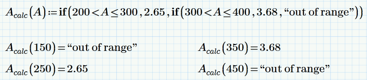

Can somebody help me with my problem I am new at mathcad and I have this problem.
Example if A is 201-300 its value in calculation is 2.65
And if A is 301-400 its value in calculation is 3.68. So what i do so it calculate it correct answer.

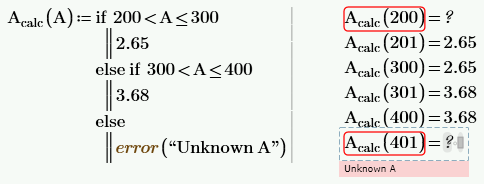

Are you looking for something like this?
If you only intend to make this calculation once, you might prefer to avoid the function:

Ah, I think you interpreted the question the way it was intended, Mark.
While I, too, prefer the programming "if" statement because it looks clearer, I'd like to point out that there is also an "if" function, which works in Prime Express, too:
