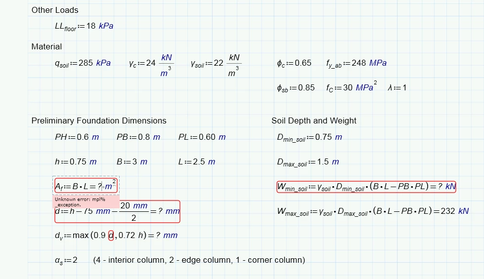

I have been having problem with Mathcad Prime 3.1 crashing lately.  First, when I load my files, some random equations will be red-circled as "Unknown Error: mpl%_Exception".  (see attached image).  As soon as I start changing the values on my worksheet, Mathcad would crash.

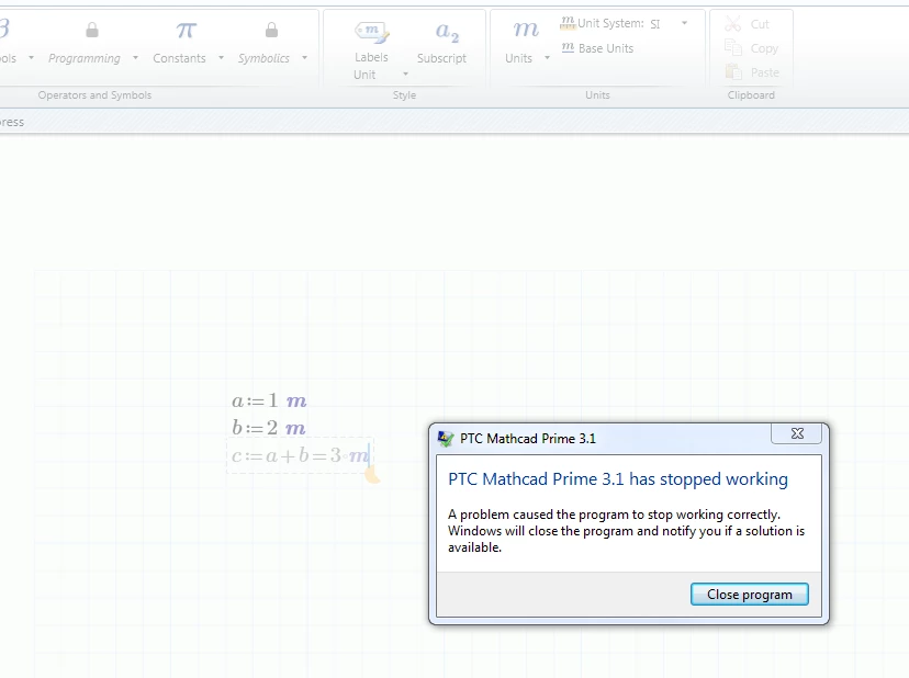

At first, I thought it might be migration issue from my Prime 2.0 file to Prime 3.1, but I realized even if I try a simple calculation in a new file, Mathcad would crash.
ex. a:=1m, b:=2m, c:=a+b=  (see attached image)
I am now stuck, not being to load any of my worksheets.  Could anybody offer any suggestion or explanation?

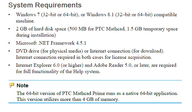

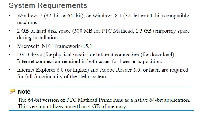

Dou you have a "Microsoft .NET Framework 4.5.1" installed on your Windows OS? And you need a better to use Mathcad Prime 3.1 64-bit version on PC (how to setup 64-bit version can be found in the attached file).
System requirements for Mathcad Prime 3.1:

  • Yes, I used the 64 bit of version of MathCAD Prime 3.1
  • Yes, Microsoft .NET Framework 4.5.1 is installed, also 64 bit version
