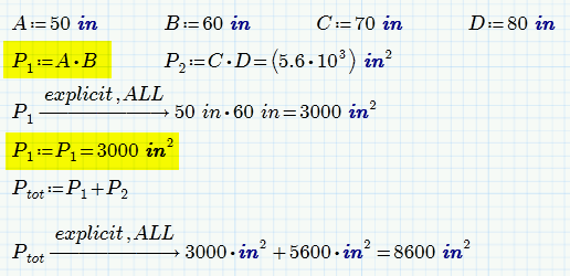

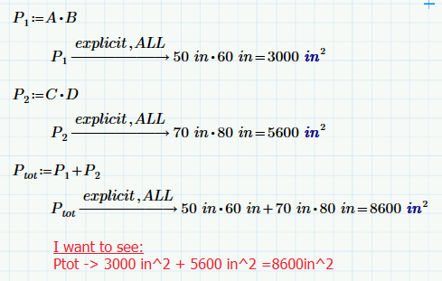

I'm trying to accomplish the following.  I want to symbolically show calculations along the way to enable basic troubleshooting.  Easy enough, but in the later equations I only want the prior results to be shown, while mathcad prime continues to plop in the whole equation even if it's been evaluated.  Here's my very simple sample.  I'd like to simplify the expression for Ptot by showing the previous results.  But I can't seem to get there easily.  File attached.  Thanks!

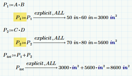

Yes, showing P1 and P2 also is my goal.  (the actual equations are far more complicated and I desire to have this visual check included for every equation.)  But with some tinkering I think I've found my solution that is more compact version of what you came up with. (but essentially the same thing)
It seems odd (almost wrong) to be redefining P1 but it seems to work and is quite compact.  I can live with this, so I think it's solved.  Thanks.  Now if they'd only let me control the number of decimal places in the symbolics....

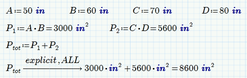

Maybe it helps if you symbolically undefine A through D just before the definition of Ptot.
April 27, 2016
Maybe that way
April 27, 2016
If you need to show the calculation of P1 also via explicit, you must not use inline evaluation before.
Inline evaluation stops the backtracing of the symbolic explicit.
So can do something like the following:
