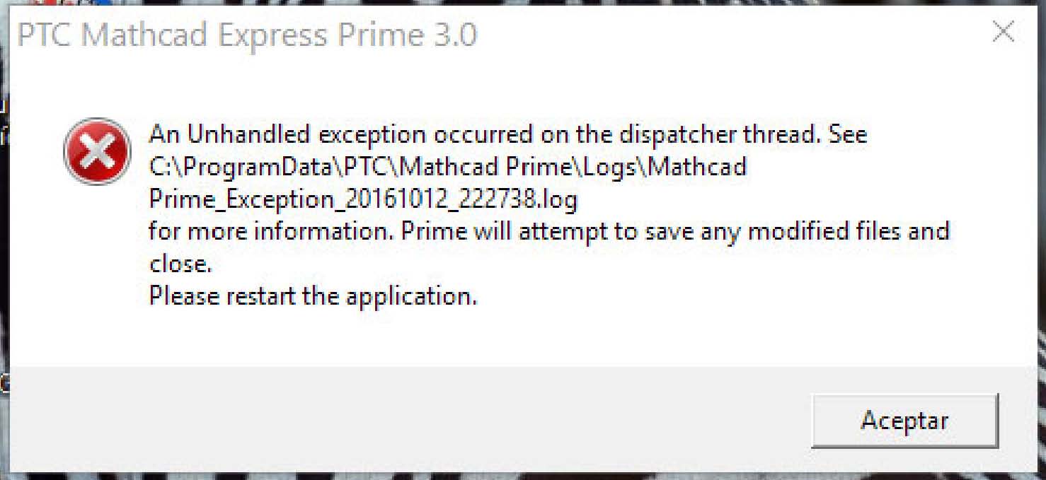

mathcad prime 3 doesn't work. "Unhandled exception ....."
I can't open Mathcad Prime 3.
I suffered a power cut.
I tried many times and it fails.
I've reinstalled the program and the problem is there.
Error:
How can I solve the problem?

Mathcad Prime 3 doesn't work. Error "An Unhandle exception..." SOLVED
PERE VENTURA CASALINS wrote:
I've found the solution => delete archive: user.config (is a hidden archive inside the AppData).
I've deleted this archive and now the program opens and runs.
