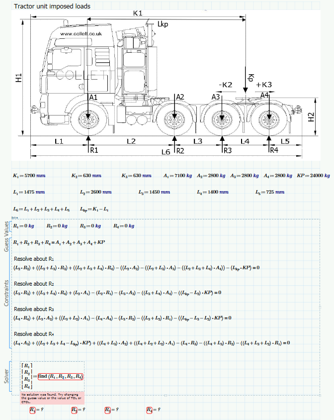

I'm slightly confused, can any one see why this will not solve.  I have 4 equations and 4 unknowns.
link is attached below.
any help would be greatly appreciated.
Thank you in advance.
I have tried putting all the static values in the guess values
https://www.dropbox.com/s/eh8hesqd5t0z9v1/T50047%20Tractor%20imposed%20loads.mcdx?dl=0

Hi David,
Please attach your Mathcad Prime worksheet (but without pictures in the document) to the message ("Use advanced editor" --> "Attach").
September 18, 2015
File attached now
I looked for that option when I was posting before
Thank you

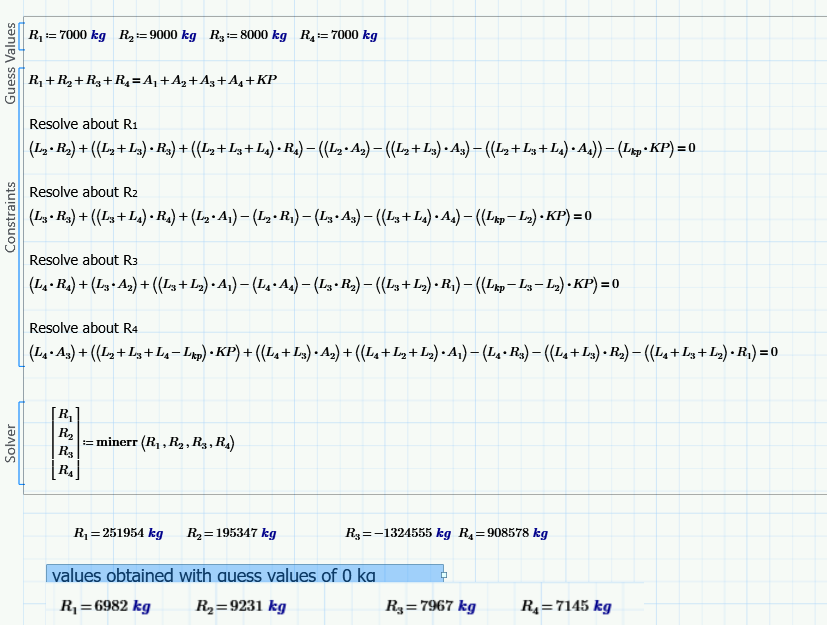

September 18, 2015
It perhaps can't find an equality because there isn't one.  I replaced find with minerr and your equations appear to be quite sensitive to initial conditions.
Stuart
