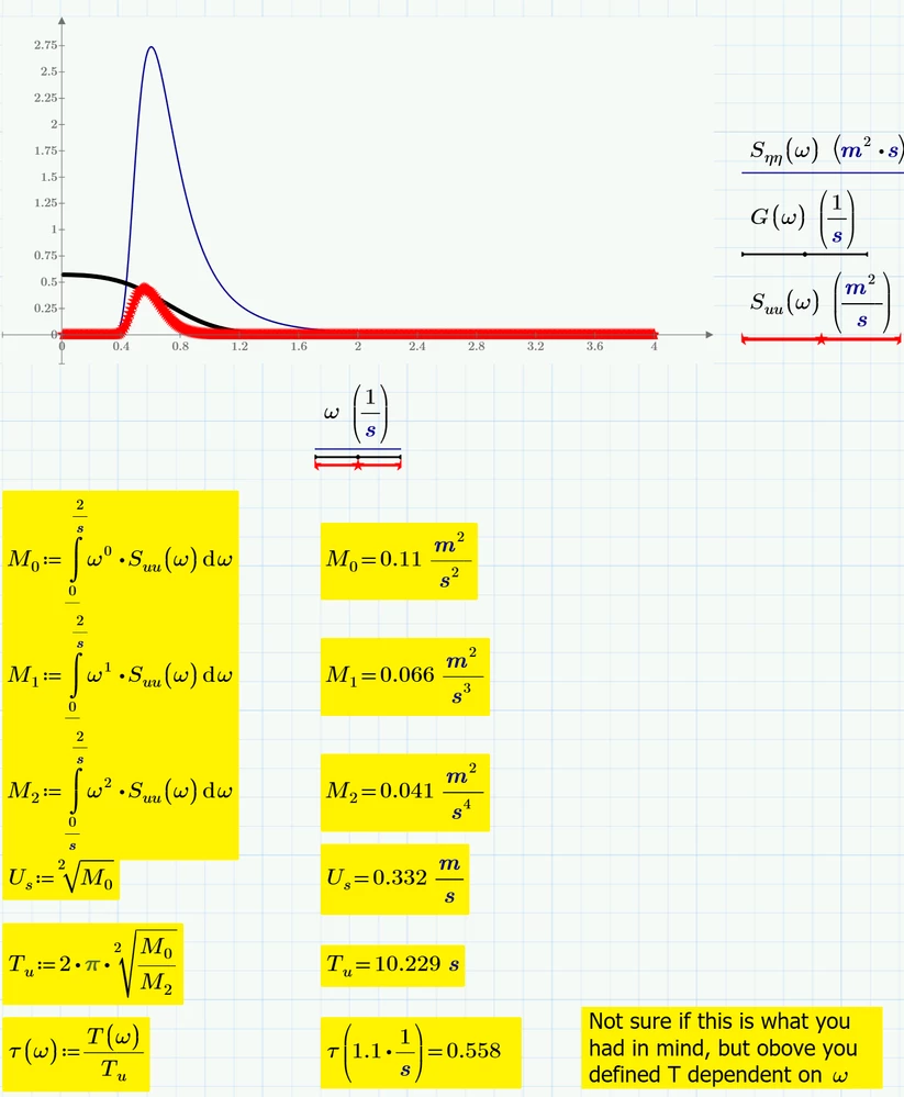

Hey Guys,
I have a problem in Mathcad Prime 4.0 related to Integration problem and Plotting Problem NEED HELP ASAP Please ( File attached )

There are several problems in your sheet.
Solve the problems, then come back if needed.
December 9, 2018
Thank you so much, the graph has been solved but for the integration it doesn't want to be solved.
December 9, 2018
This mixture of vectors and functions is quite a mess and you seem to have confused yourself with it.
I would strongly suggest setting up all calculations as functions of omega and getting rid of any vectors completely.
After all this is math program and not a spreadsheet!
See the attached Prime 5 file how this could be done.
