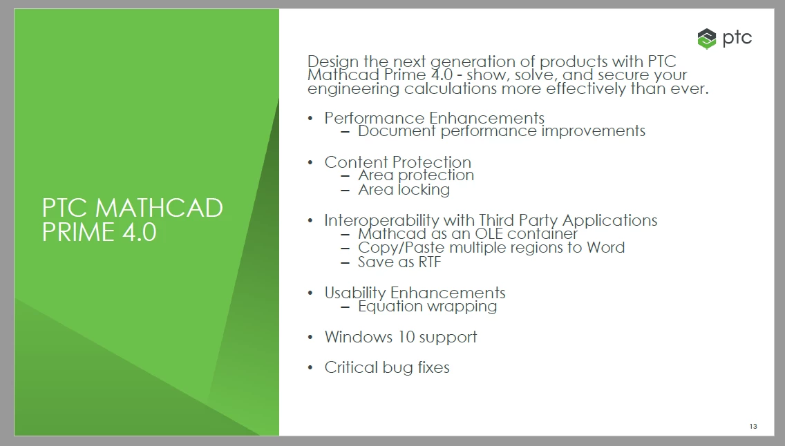

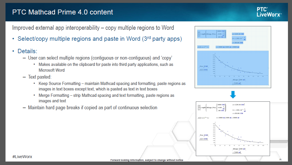

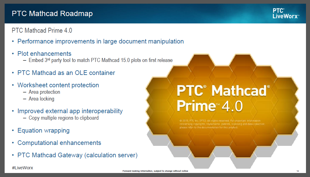

Here is a list of major improvements for Prime 4.0:
  • Plot enhancements (embed 3rd party tool);

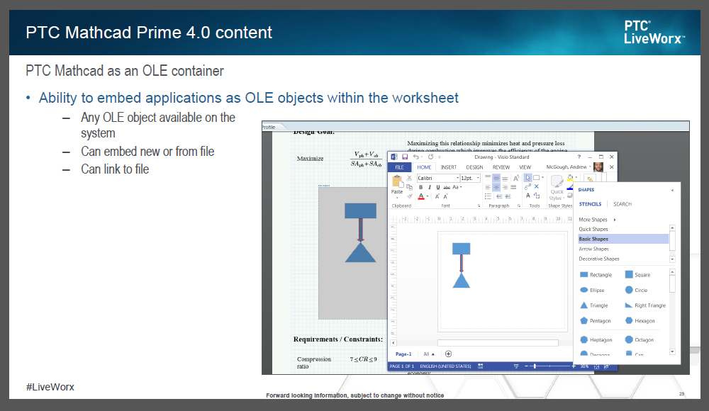

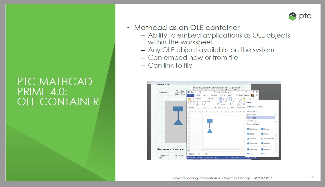

  • Mathcad as an OLE container;

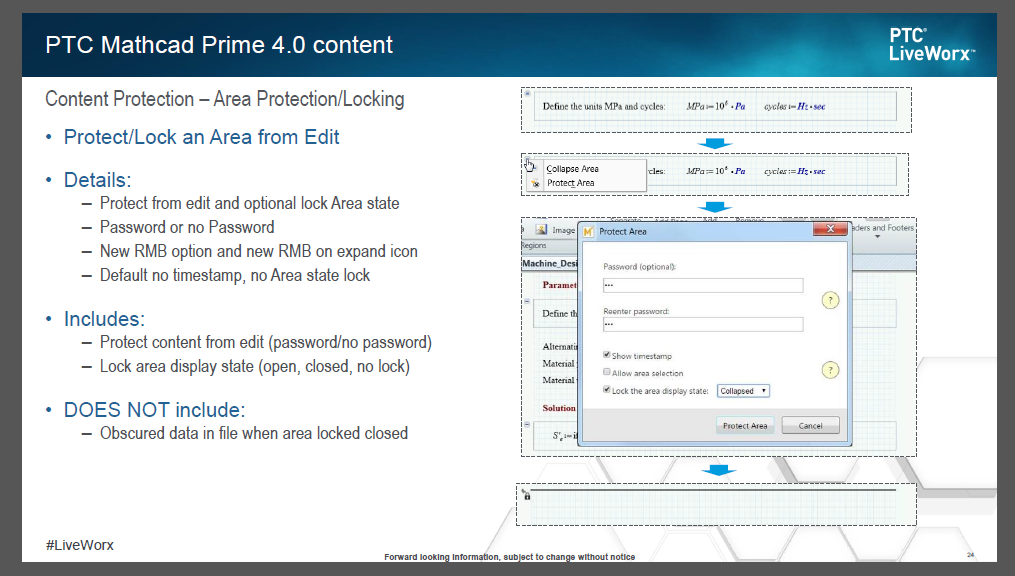

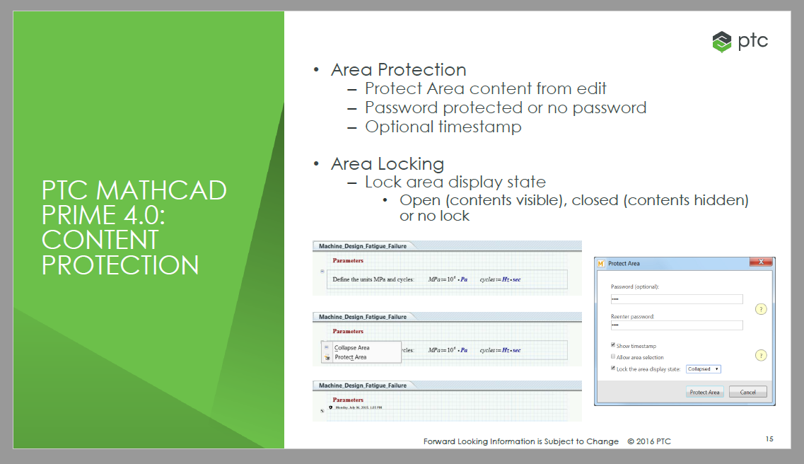

  • Worksheet content protection (area protection/area locking);
  • Copy multiple regions to clipboard;

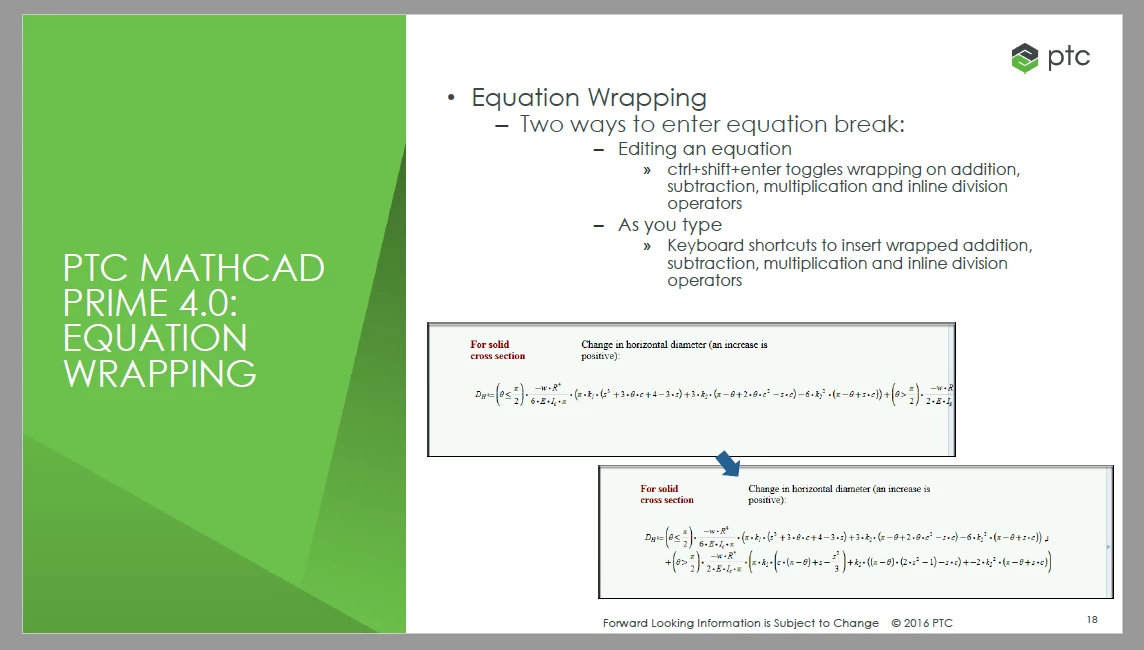

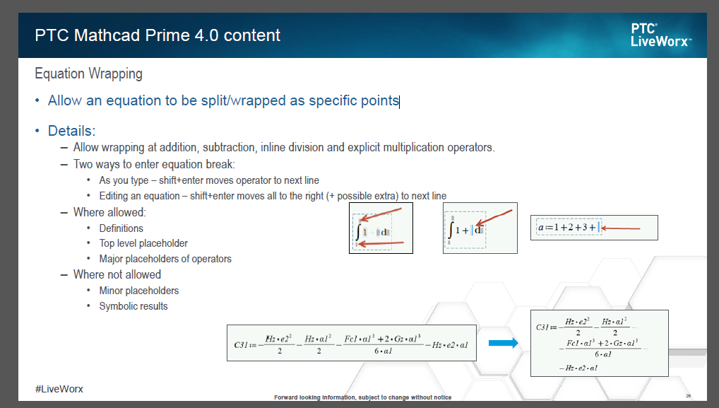

  • Equation wrapping.

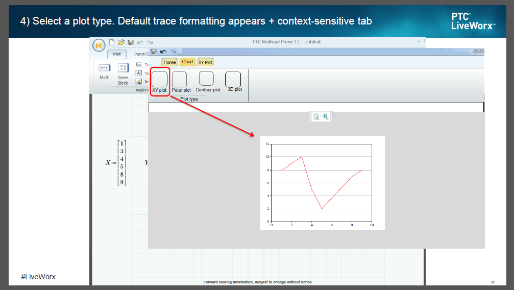

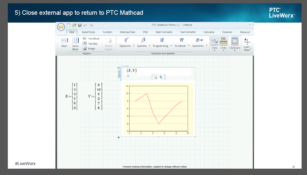

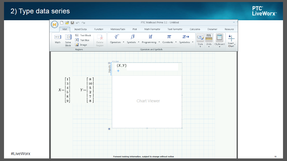

1. Plot enhancements: embed 3rd party tool to match PTC Mathcad 15.0 plots on first release.
2. Mathcad as an OLE container: ability to embed applications as OLE objects within the worksheet.
3. Content Protection: area protection/locking.

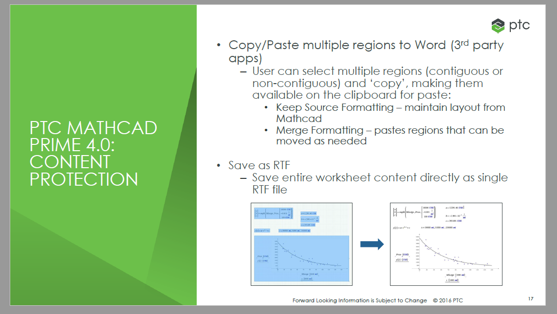

4. Improved external app interoperability: copy multiple regions to MS Word.
5. Equation wrapping: allow an equation to be split/wrapped as specific points.

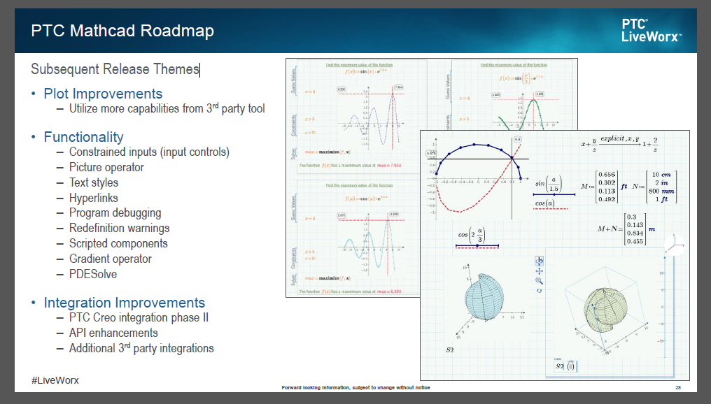

6. Subsequent release themes.
• Plot Improvements
     – Utilize more capabilities from 3rd party tool
• Functionality
     – Constrained inputs (input controls)
     – Picture operator
     – Text styles
     – Hyperlinks
     – Program debugging
     – Redefinition warnings
     – Scripted components
     – Gradient operator
     – PDESolve
• Integration Improvements
     – PTC Creo integration phase II
     – API enhancements
     – Additional 3rd party integrations

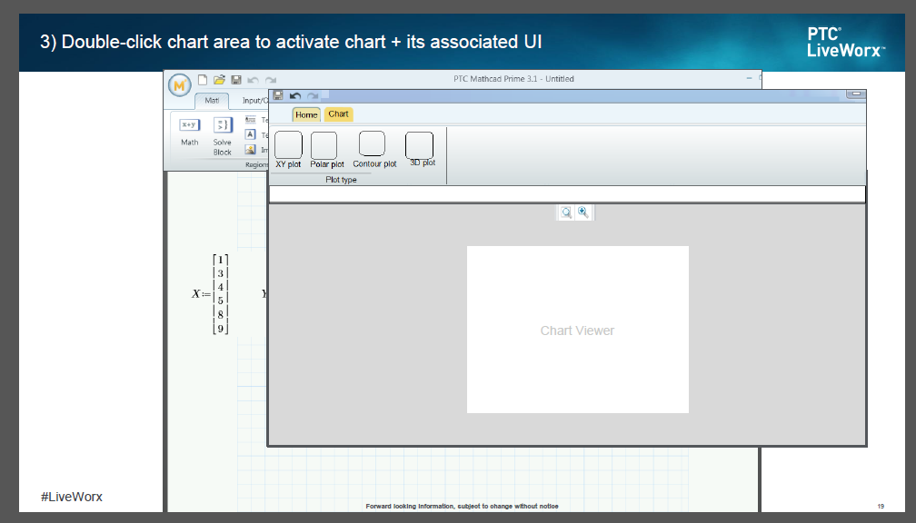

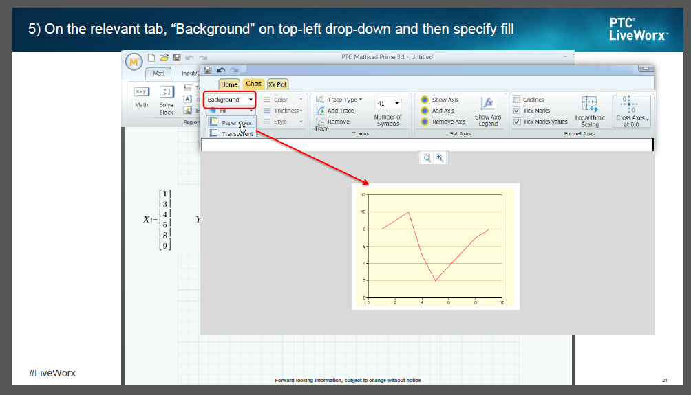

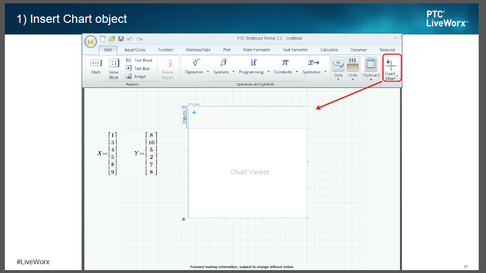

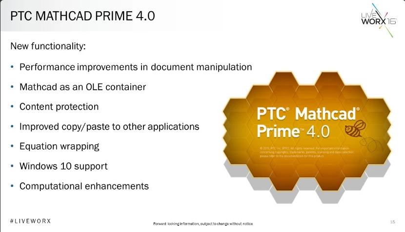

Screenshot from Mathcad Prime 4.0 preview at LiveWorx 2016:
It was also noted that Mathcad Prime 4.0 is coming in December 2016. New timeline for Mathcad/Mathcad Prime product:
New post "Report from LiveWorx: A Peek at What’s Coming in Mathcad Prime 4.0" on Mathcad blog: Report from LiveWorx: A Peek at What’s Coming in Mathcad Prime 4.0  | PTC

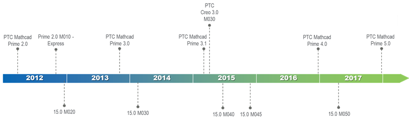

In June of 2016 year within an annual meeting conference "PTC LiveWorx 2016" the new program of development for Mathcad Prime was submitted. For future release of Mathcad Prime 4.0 the same new planned features were shown in the program about which I wrote earlier above here (except for expanded options of creation of 2D plots - this feature is transferred it for 5.0 version). PDF "PTC Mathcad Roadmap_2016" can be found in attachment.

Yesterday came the announcement of the release at the end of February 2017 the new version of Mathcad Prime 4.0. Data sheet for this release are in attachment.

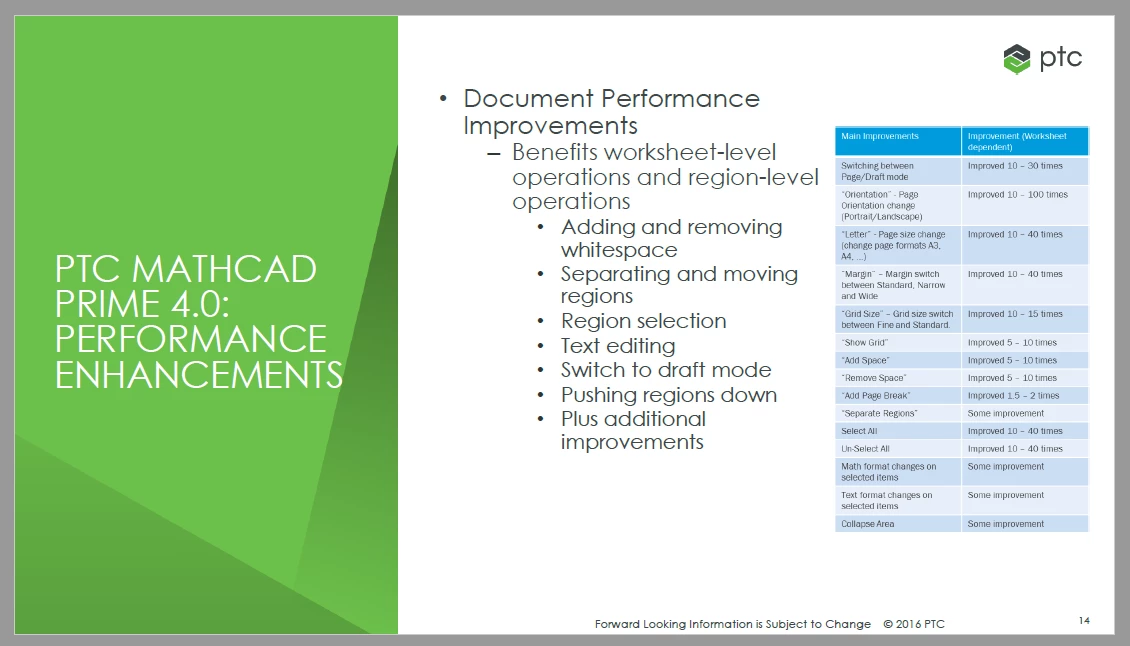

From what I see we are the beta testers, I think they don't even have official beta testers for Mathcad, why would they, as there are no new features to test. Now the number one feature in the new version is a speed increase. Can you believe it? It has taken them 4 versions to realise that Mathcad Prime runs like a dog.  They promote a speed increase as their no 1 feature. What planet are these guys on?
