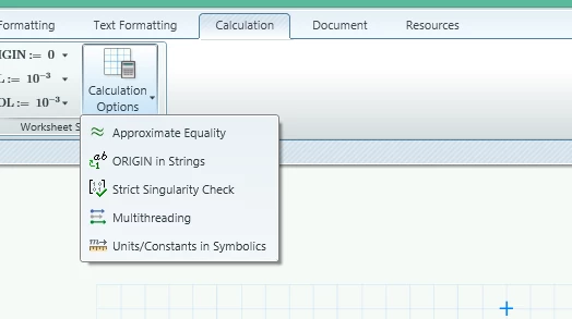

Try to turn off "Multithreading":
1. Go to "Calculation" tab --> "Calculation Options" button.
2. Click on the "Multithreading" button.
