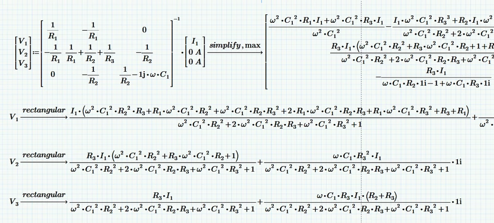

I wanted to create the Y BUS matrix from Netlist and solve that to get currents and voltages of each node.
For this i need to know how to solve the AX=B in matrix format, if all matrices(A,X and B) having variables only,
I want X in terms of Varibales(eqn)
Please check the 29th page of this pdf:
http://www3.imperial.ac.uk/pls/portallive/docs/1/7292571.PDF

You may possibly be able to do what you are looking for, but as long as an expression contains an unknown/undefined variable you obviously can't evaluate that expression or function numerically (that means using the normal =).

you just use:-
Regards
Terry
December 18, 2018
I will try this post again to get the graphic:
You just use:-
Cheers
Terry

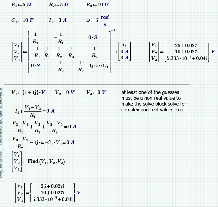

Please check the attachment, that one i am not able to solve

The inverse of a matrix times the matrix is the identity matrix (all zeros except diagonals being one)

Do you really need a general symbolic solution? It looks a bit uncomfortable:
Wouldn't do a numerical solution do the job good enough?
You may either use the matrix approach or a solve block with the original node equations.

I need the solution in symbolically..means interms of variables like in X,y
