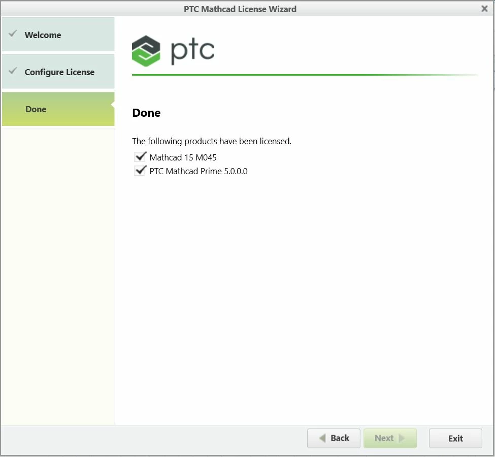

Mathcad Prime 5.0 opens as express
I opened Mathcad Prime 5.0 today and it opened as express.  I tried to reactivate the license, but it just tells me that the products are licensed.  I purchased the yearly subscription and I am due to renew on the 22nd, so it should still be active.  Not sure what to do.  I have the license file saved on the computer, and pointed the license manager to that file - but it stays in express.
What do I need to do?
July 16, 2020
Thank you for your answers.
I finally figured it out by going into options --> license and it told me that it cannot perform the function via a services terminal.  I am remotely accessing the computer where Mathcad resides - and apparently you cannot do that???  I had to go to the office and login directly and now it works.  Not a great option with so many of us working remotely.
