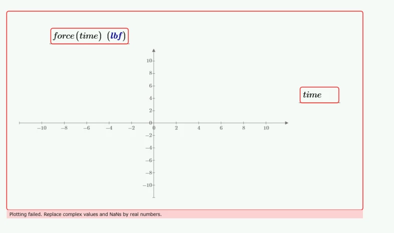

Mathcad Prime 5.0: Plotting failed. Replace complex values and NaNs by real numbers.
Greetings,

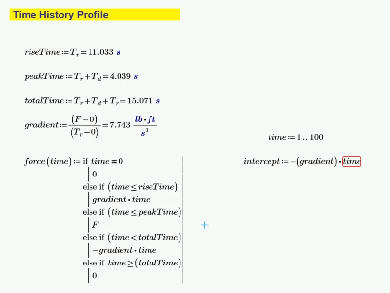

I am working on this task where I need to plot a variable against time. However, I am getting an error saying "Plotting failed. replace complex values and NaNs by real numbers". Can someone help me sort this out?
October 22, 2019
You need to assign your "time" range in seconds - you're trying to compare a unit-less value against values with units of time.
October 22, 2019
