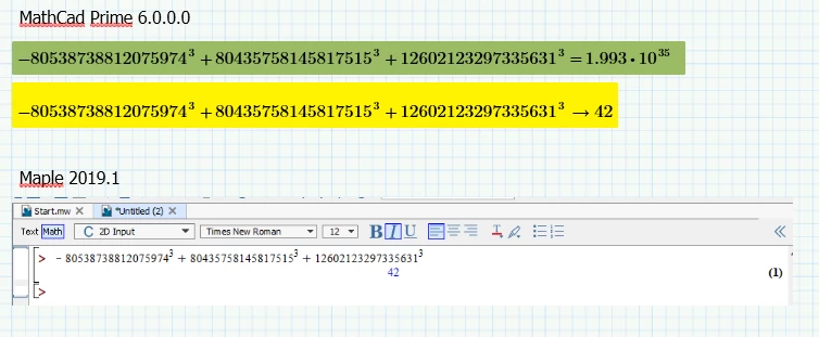

can anyone test this in 6.0?
October 3, 2019
Please find below.
October 3, 2019
Wow, the result looks like it's giving us is the "Answer to the Ultimate Question of Life, the Universe, and Everything", ...42. It must be correct!

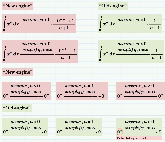

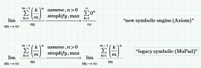

Here is my first test of the new symbolic engine.
As you can see neither the old nor the new engine come up with the result 1/(n+1) but the result of the new engine sure is nonsense (a further evaluation yields a wrong 0, of course).
Also Wolfram Alpha is not able to come up with the result 1/(n+1) but at least points to the general harmonics.

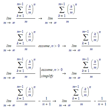

@LucMeekes  What about Maple in MC11. Is it able to come up with the simple result?
The limit of course can be seen as Riemann sum of a simple integral. The way the new engine shows the result is not promising, too 😞
