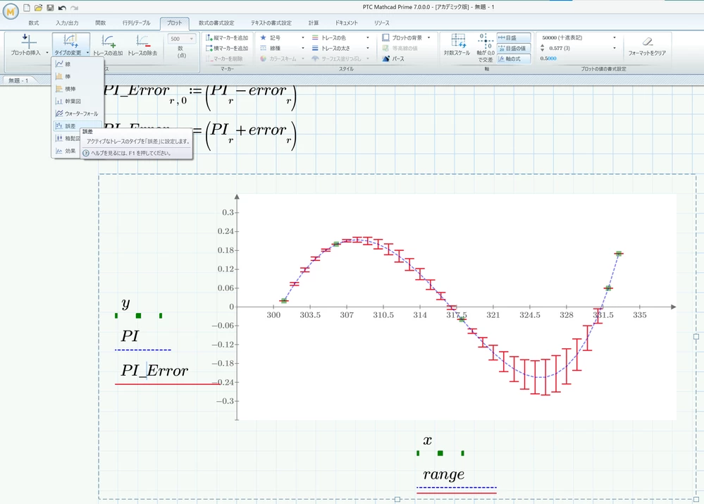

Ho can I plot the red error bars from plot with polyint?
ttokoro
May 12, 2021
t.t.

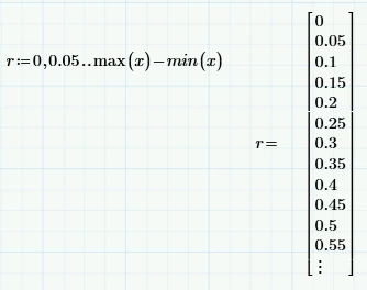

cnabold1-VisitorAuthor
May 12, 2021
why dows
not work?
r:= 0,0.5,..max(x)-min(x)
r:=0..max(x)-min(x) works fine (from example from Mathcad help pages)
May 12, 2021
I don't see the problem?
Works fine, as long as you do NOT type a comma (,) after 0.05
May 12, 2021
Unfortunately in my case your solution does not work. If you change the statement
r:=0..max(x)-min(x) to r:=0,0.05..max(x)-min(x)
then the next statements do not work anymore (underline r is flagged as error)
