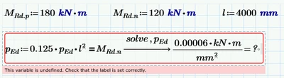

Recently upgraded from Mathcad Prime 5 to Mathcad Prime 8, but when I try so solve an equation containing units in Prime 8 it converts them all to variables and I can't get the answer as it now contains undefined variables.
Doing the exact same thing in Mathcad Prime 5 and it keeps the conversion and gives me the correct answer.
Am I doing something wrong. and is there any way to fix this?

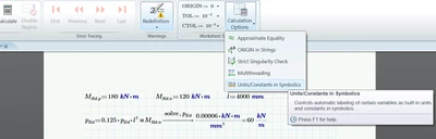

Turn on the "Units/Constants in Symbolics" option in Calculation Options on the Calculations tab!

Thanks a lot. After turning this on and restarting the work sheet it fixed the problem 🙂

Not sure, you may try turning on "Units/Constants in Symbolics" at the calc options, recalc and see if it helps
EDIT: Had not seen DJNewman's reply when I started mine. He is suggesting the same.

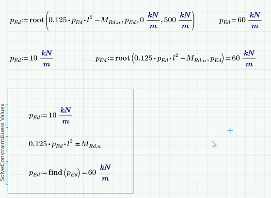

Mathcad is a number cruncher and if you don't really need a symbolic result its always better to resort  to its numerical methods.
Basically you have available the "root" function by providing a range, "root" function using a guess and a solve block with "find". The following picture shows all three ways:
