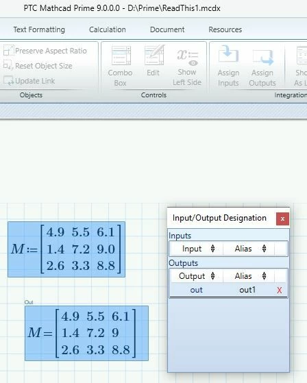

The fix is real simple.
Element (1,1) is 7.2.
matrix.MatrixResult.GetMatrixElement(1,1) returns 0.
0 is the return code of the function.  0 represents a good call
simply add in the variable for the value returned to the left hand side of call
[rc b]= matrix.MatrixResult.GetMatrixElement(1,1) returns 0, and 7.2
