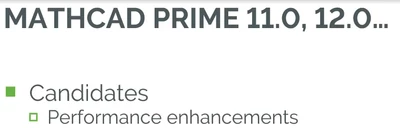

In the Mathcad Virtual Conference 2023, he shared the roadmap for Mathcad Prime 10 as well as releases beyond that:
I took a screenshot of the top bullet point for Mathcad Prime 11, which was "performance enhancements". As he was going over his thinking during the roadmap session, he verbally acknowledged problems around performance and rearchitecting Mathcad Prime to address this is the top priority for Mathcad Prime 11.
Please feel free to securely share your Mathcad worksheets and benchmark tests by opening a case with PTC Support and attaching the sheets. I believe that's helpful for them.

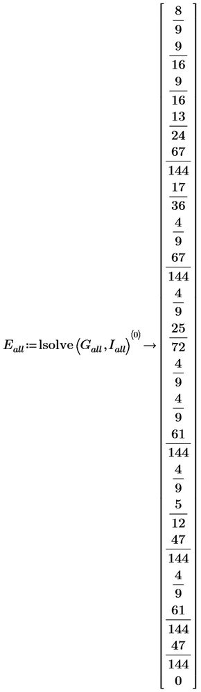

I solve electric circuit like this. If the unknown's number is small, Mathcad can solve both symbolic and numerical.
However, if the number of unknowns increases symbolic engine need very long time to solve.
So I don't evaluate the results symbolically.
image.pngimage.pngimage.pngimage.pngOnly small number of unknowns.
