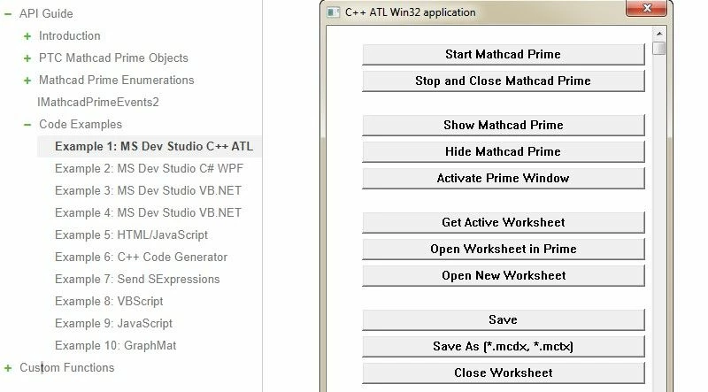

I suggest starting with the help file which has an example in C++
