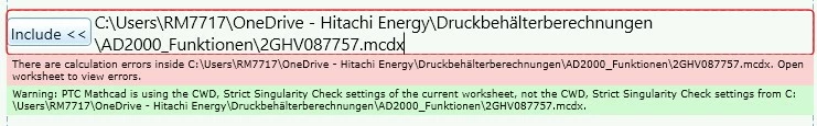

Hi everybody,
I have calculation sheets that utilize a reference to a different sheet that contains subroutines to calculate coefficients, factors etc. for the main sheet.
In Mathcad 15 this works just fine, in Mathcad Prime 9 however, an error message (see attached image) is returned by Prime, claiming that there are errors in the calculation sheet.
Has anybody figured out how to find these errors? When I open the Prime sheet no indication is given that points to the error. As I said, the sheet works in Mathcad 15, so I assume that the calculation is ok.
Any ideas?
Raiko

Hello Raiko,
the error message gives one clue:
-Check the CWD setting and strict singularity settings of the including versus the included sheet.
Another (less likely) cause could be the filename, which includes a non-standard ascii character, the ä.
Prime is known to have problems with certain characters appearing in the filename. If the problem disappears when you change the ä to e.g. ae , you have found another such character.
