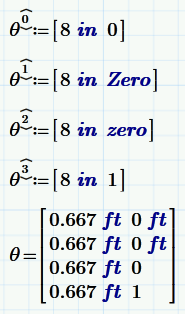

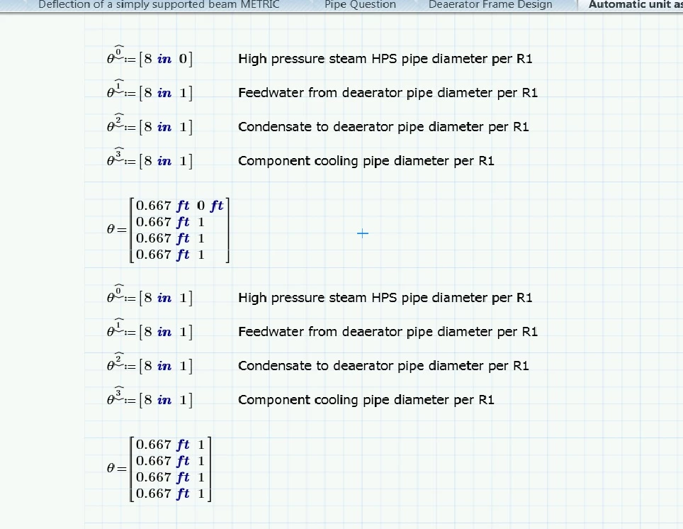

In the attached 3.1 worksheet 4 1x2 matrices are being combined. The values in the first column have units while the second column is unitless. For some reason Mathcad is adding a ft unit to the 0 value. If changed to 1 the units disappear. Why does this happen?
Werner_EAnswer
This is why we have "Zero" and especially "zero" as units:
Werner_E25-Diamond IAnswer
dsochor1-VisitorAuthor
Didn't know zero was a unit, thank you!
The reason for this is the dynamic unit checking in Prime which makes it possible to collect values of different dimensions in one array (not possible to do in Mathcad 15).
You can read about those zero and Zero units/constants in the Prime migration guide.
