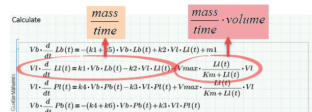

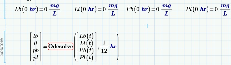

I am new to Mathcad and am getting the error "unable to form derivative matrix" when using OdeSolve. I think I may not be able to use OdeSolve inline like I am doing, so I tried putting it outside of the solve block as well. Can anyone confirm this? And what should I do instead? I appreciate your help. I am re-posting this because I have changed the code since then thanks to help, but am still getting the same issue. The file is attached, and the screenshots are displayed below.

I fixed part of the issue by using the differential operators in the drop down menu instead of just typing d/dt. However, now i get "units are not compatible". Does anyone see why?

Two of your summands have a wrong unit / dimension. Somehow you have to check again your equations. Those summands must be divided by liter ot the like.

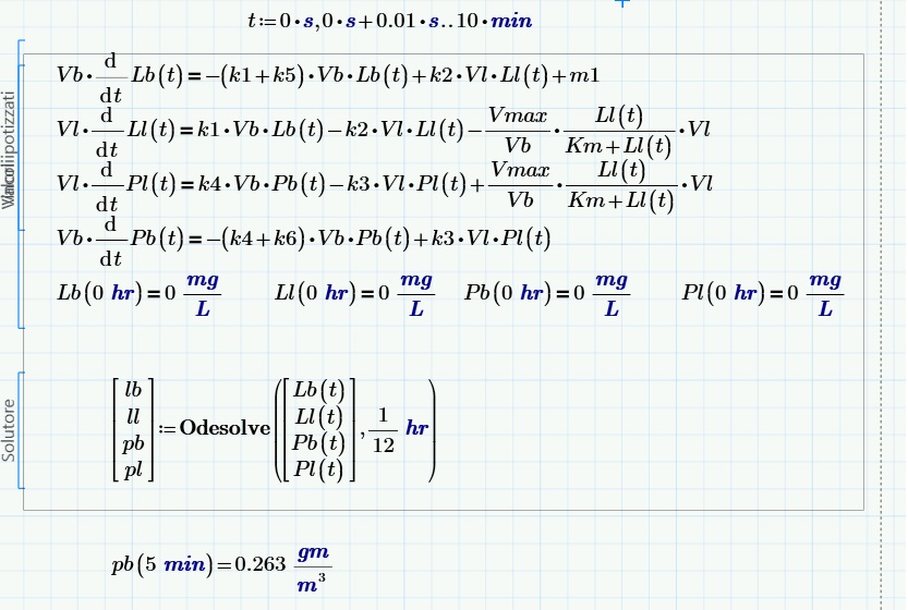

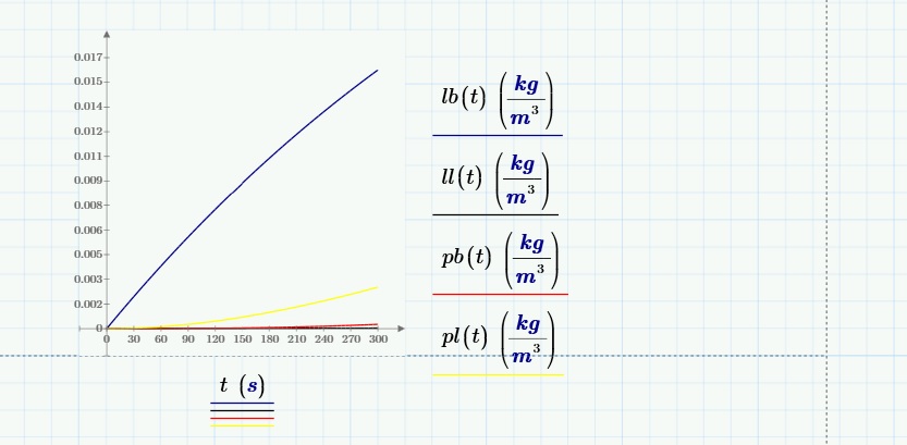

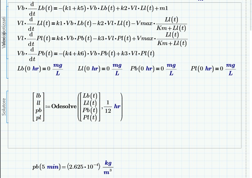

Hi tj lafata,
you have to do even this small correction:
You have to use as a derivative  the operator defined by mathcad. You can't write d/dt Lb(t)...
Assuming that the last term in second member of the second and third equation, is not multiplied by Vl, you have:
or dividing, for example by Vb the last term in second member of the second and third equation, you have:
