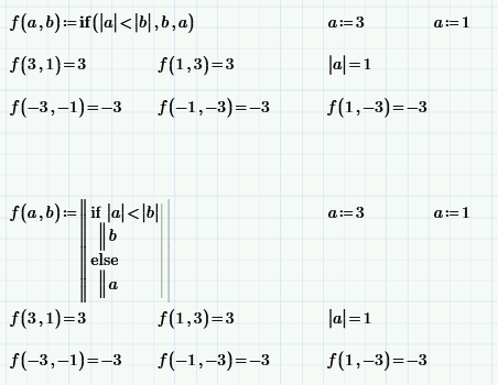

Could you please post a worksheet with an example of it crashing?  I don't seem to be having the same problem. Thanks,
Stuart

Well, turning it on crashed my Prime 3.1 after clicking Calculate a few times.  The worksheet raised an mpl% exception error for f(-1,-3), the first couple of times, then threw its teddy bears out of the cot the third time.   Unfortunately, whatever was going on prevented me from getting a screen shot using the PrtSc key on my Win 10 PC.
Stuart
