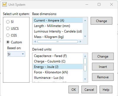

So I have just installed MathCAD Prime 11 so that I can finally have custom units. So now I can get 'MPa' and mm as my preferred units, but how do I get MathCAD Prime 11 to evaluate a moment as 'kNm' instead of  'J' (joules)?

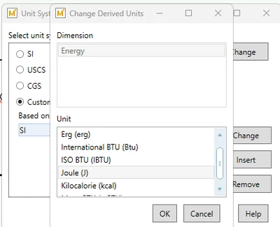

May 1, 2025 7:30 PM UTC
I don't see how you do that?
this is what I am faced with, there is no option to change the unit associated with energy as far as I can tell. When you click on change there is no option to change it to kNm?
23-Emerald V
May 1, 2025 9:57 PM UTC
The unit kNm isn't known by Mathcad, you'd have to define it first as (e.g.) :
be sure to have kNm, N and km labelled as Units.
What happens if you change the unit for energy to BTU...do then your moments change to BTU?
(If not it's no use trying to get kNm in there).

May 1, 2025 10:32 PM UTC
Mathcad Prime 11.0.0.0.0.0.0 "custom unit system" is half baked.  I am so frustrated that we waited for such a minor improvement.  You can only use the limited list of derived units and absolutely no support for "coherent units" of any combination!
For example, I use mm^2, mm^4 and mm^6 quite often, yet the default is still m^#.  Also, I deal with solids all the time yet volumes are in L or gal—I usually do not fill up a jug with steel!  I definitely do not need "Barns" for areas!!!
