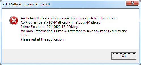

I had installed Mathcad Prime. I did not use it for a few weeks.When I try to write an expression or anything else, Mathcad gives below error and exits.
I have attached the log file.
Could anyone help me about the issue?

agoksuAnswer
Jul 7, 2014 8:02 AM UTC
hi friends,
for solution of this problem,
open control panel-> region and language
change format as "English (united states)
thank you

Jun 11, 2014 6:51 AM UTC
Orkun,
What Windows OS are you using? Note that Mathcad Prime 3.0 requires "Microsoft .NET Framework 4.0". I had a this error, but only when I spent the beta testing MP3.
otarakçi1-VisitorAuthor
Jun 11, 2014 7:14 AM UTC
Vladimir,
I have Win7 64bit installed.Framework 4.0 is also installed.
