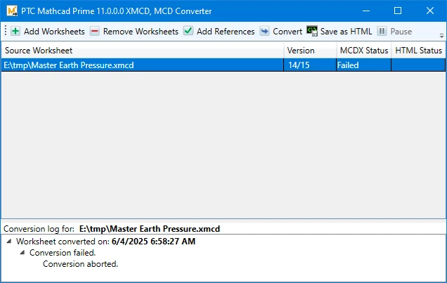

What makes you believe that the conversion failed?
Prime either converts the Mathcad 15 file and produces an .mcdx file, possibly with some hints on issues it encountered, or it fails to convert and then no .mcdx file is generated.
So if you have an .mcdx file, that should be the converted .xmcd file.
You should still be able to open the .xmcd file with Mathcad 15, but you cannot open the converted .mcdx file with it. For that you need to use Prime.
I can confirm that conversion failed in MCP 11.0.0.0.
Master Earth Pressure.mcdx_exceptions_log.txt contains following error description.
Exception data:
System.ArgumentException: Unrecognized structure in data format 'Rich Text Format'.
Parameter name: stream
 at System.Windows.Documents.TextRangeBase.Load(TextRange thisRange, Stream stream, String dataFormat)
 at System.Windows.Documents.TextRange.LoadVirtual(Stream stream, String dataFormat)
 at Ptc.PersistentDataObjects.PresentationSettingsDataObjectCreator.ConvertHFPaneText(String hfPaneText, LocationInfo locationInfo)
 at Ptc.PersistentDataObjects.PresentationSettingsDataObjectCreator.ConvertHFPane(headerFooterPaneType hfPane, LocationInfo locationInfo, IDictionary`2 headerFooterImagesMap, IList`1 regions)
 at Ptc.PersistentDataObjects.PresentationSettingsDataObjectCreator.CollectHFObjects(headerFooterType hf, Boolean isHeader, Double pageWidth, Double gridCellSize, IDictionary`2 headerFooterImagesMap)
 at Ptc.PersistentDataObjects.PresentationSettingsDataObjectCreator.CreatePresentationSettingsFromMC14Xml(XmlElement presentationXml, DataObjectHelper dataObjectHelper, IDictionary`2 headerFooterImagesMap, List`1& headerRegions, List`1& footerRegions)
 at Ptc.PersistentDataObjects.DocumentSettingsDataObjectCreator.ReadDocumentSettings(XmlElement settingDataAsXml, DataObjectHelper dataObjectHelper, IDictionary`2 headerFooterImagePaths, presentation& presentation, calculation& calculation, List`1& headerRegions, List`1& footerRegions)
 at MCDXConverter7.DocumentSettings.AddSettings(String settings, String[] paths)
 at MCDXConverter7.CMcdxConverter.AddSettings(String settings, String[] paths)
23-Emerald V
Either Mathcad 15 contains a bug that can create illegal RTF structures, but it can handle those itself.
Or Mathcad 15( and before) knows Rich Text Format (RTF) structures that Prime doesn't know about and thus cannot handle, which I think is a Prime bug.
This should be reported to PTC.
