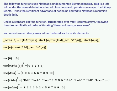

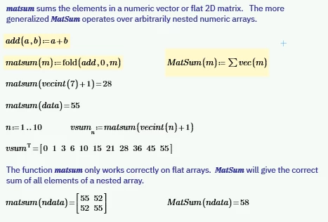

Whilst playing around trying to write a function to remove text rows from a mixed string/numeric matrix (*), I discovered that the undocumented (but very useful) function fold doesn't just work on vectors but also works on matrices, scanning down each column in turn, in the normal Mathcad fashion.
This behaviour opens up the possibility of some straightforward implementations of useful functions, such as converting a (potentially arbitrarily nested) array into a vector and summing the elements of an array.

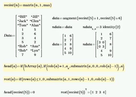

Here are some Mathcad Express 7 functions.

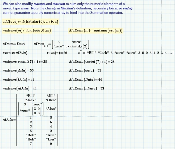

Or we could define matsum to sum just the numeric elements of an array.
Alternatively, we could shift the burden of removing non-numbers to a specialized version of vec.

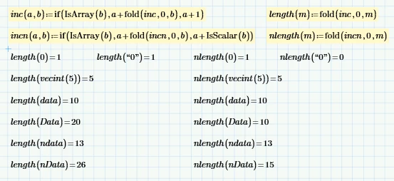

We can even count the elements in nested arrays.

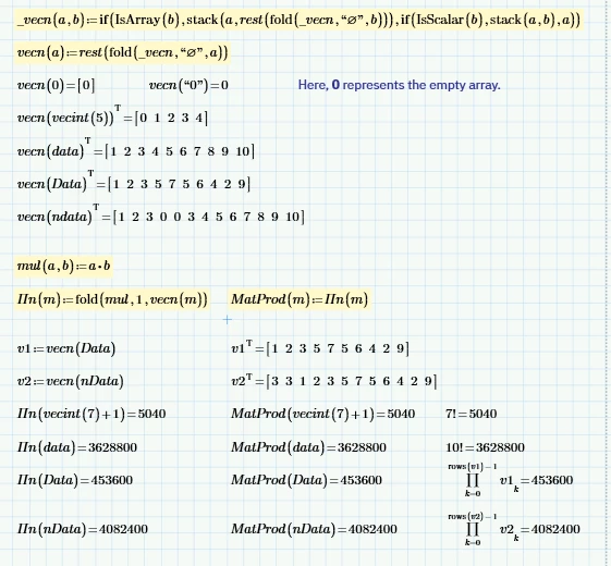

The full version of Mathcad Prime allows the user to write programs to create functions.  This facility opens up the possibility of writing a more generic filter function using fold by creating functions containing tailored boolean predicates.

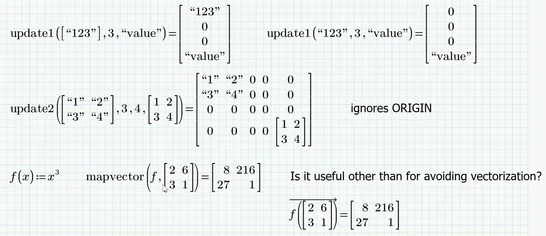

I found a few more undocumented Prime functions. Not sure about their value, though.
update1 and update2 can be used to add values at arbitrary positions in vectors or matrices and the function is not ORIGIN-aware.
mapvector seems to allow us to avoid vectorization, but then, I may not be able to see its potential right now. Just playing around with the functions for a few minutes so far.
I found those function by looking for "mc_fold" in all files in the PTC program directory and found it in some dll's (not surprising). I looked at those files with a simple text editor and noticed other mc_*** mentioned which I wasn't aware of.
OK, I also was not aware of the functions "foldover" and "fullfact2", but they are documented functions 😉
But I guess that further digging into the dll's may bring up a few more undocumented functions as well.
