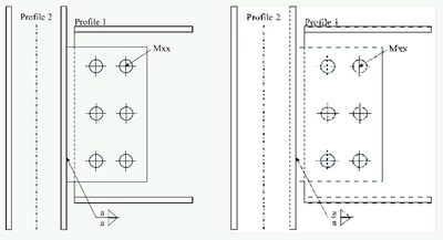

I have tried using an excel component, but the image is of a poor quality as illustrated on the right figure. It is the same image file inserted on tw different method.
the left image is manualy incluted

I sure see the difference.
Looks like a problem with scaling down the original image (either from Excel or from Prime, I suspect Prime).
You may try to resize the picture within Excel and see if it helps.
Or you may scale down the original image using a decent image editing programme and use the modified images.
