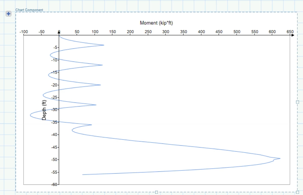

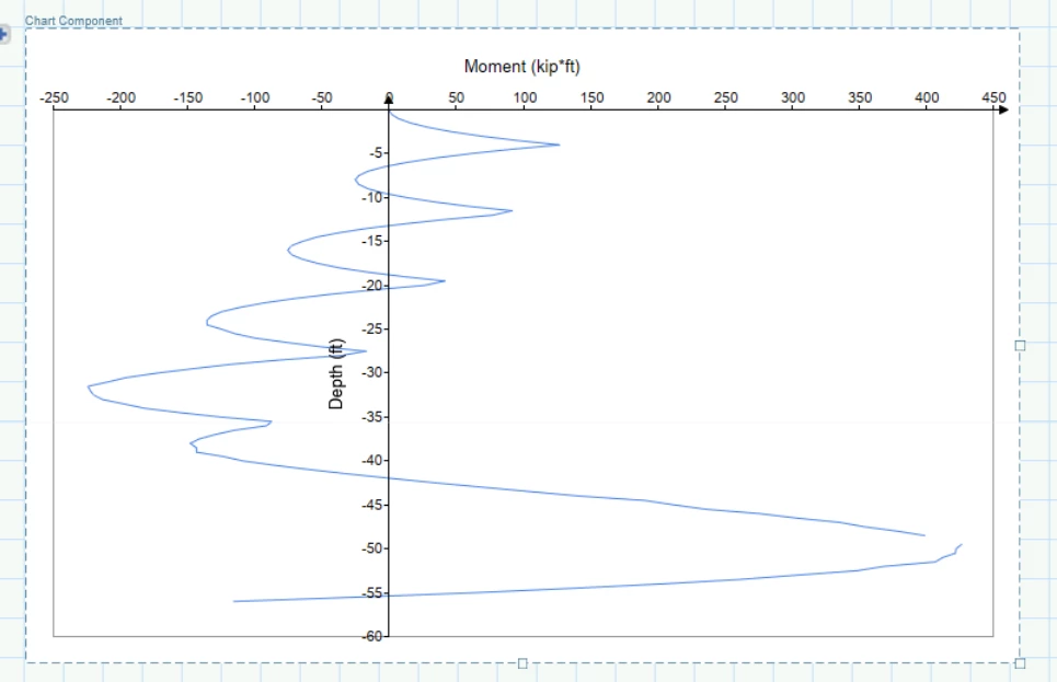

I am doing an integral in mathcad prime. The function inside of the integral is a summation of series of if statement functions and a step function (for loop).
I plotted the integral twice (see attached figures), one with a TOL of 0.01  and one with a TOL of 0.1. However, the peak values along the graph are not the same at the same depth and I don't know why they are different since I am integrating the same function. However, the function stops at the same point (where the Moment is 0 kip*ft) at the very bottom.
I am wondering why the peak values are different by changing the tolerance. Thank you.
Summing a larger number of values with a rather large value like 0.1 for TOL sure can lead to a larger overall inaccuracy.
Keep in mind that numeric integration also is just summation of a larger number of smaller values ...
We have seen quite a number of strange effects with definite numeric integrals here and sometimes it helped to split the integral into parts rather than letting it run over the full interval.
Can you post the worksheet or a smaller stripped down sheet showing the same/similar effect?
